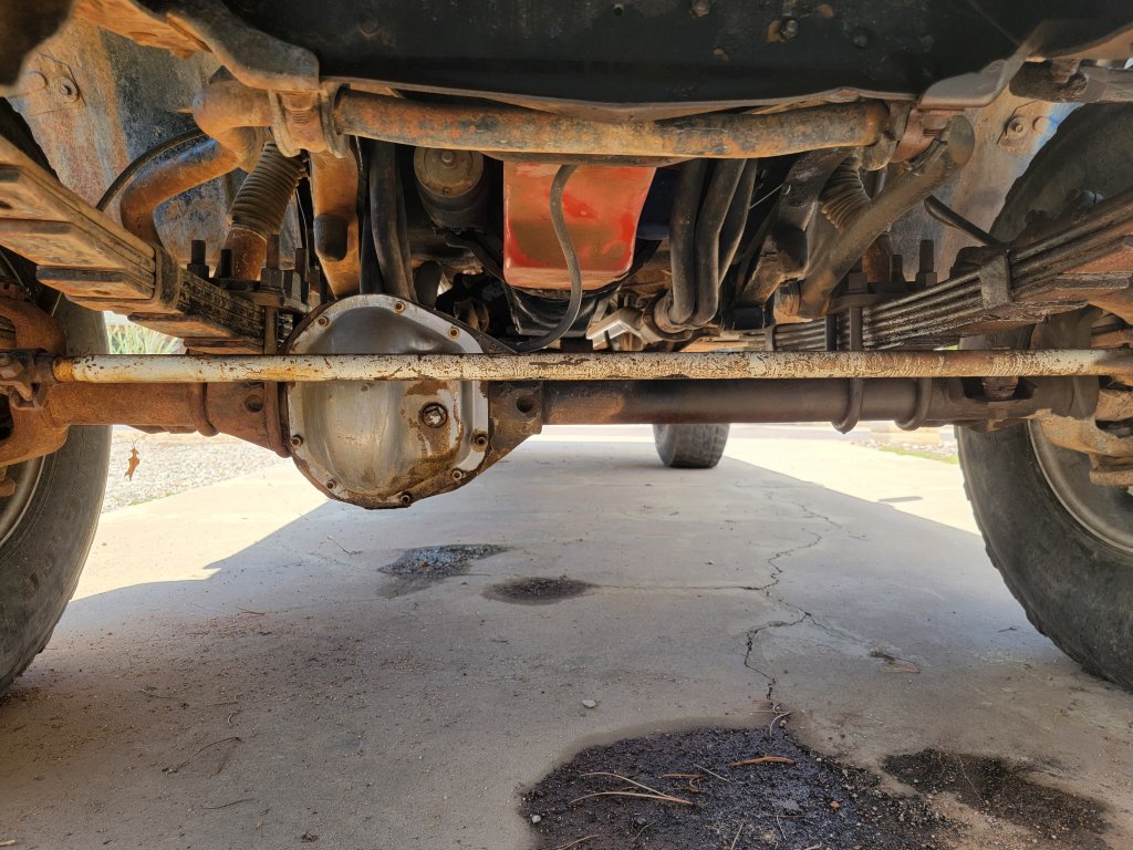

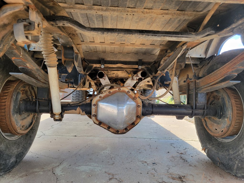

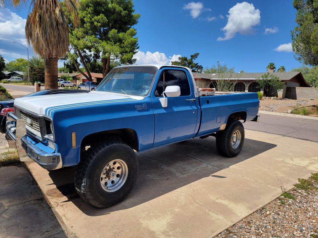

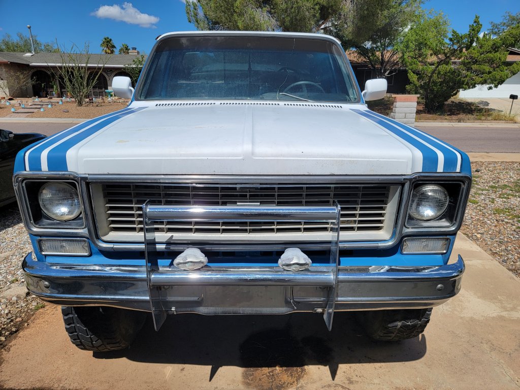

Hey guys...just got the pics of the truck. Apparently I chose to simply get to work on it right away instead of taking a single picture of it, so Iʻm glad you guys reminded me to do that since everyone is asking for pics.

Are you sure those are not original axles? The front looks like a Dana 44, and that's what they would have used in 74. To remove the steering arm hit the side of the arm right next to each stud. You may have to hit it pretty hard but the cone should pop up out of the arm and you can slide it off the stud. Start at the end away from the curved arm, and penetrating oil helps
