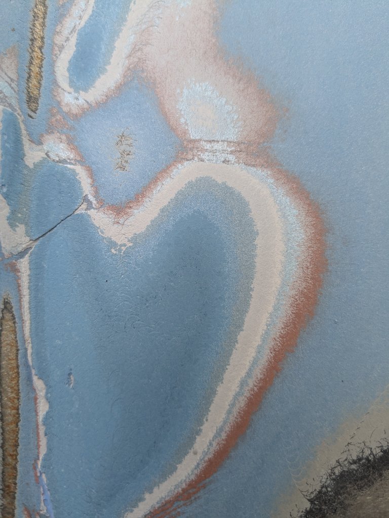

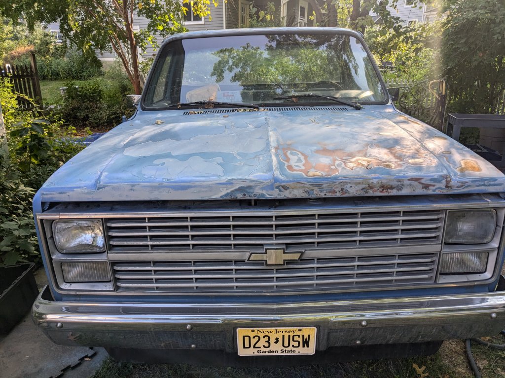

Sanding the hood, how many layers do you see on this ONE owner truck? I count at least 6. Ha ha this is going to have to be sand blasted some day but not now just rattle can until the swap.

Id chemically strip it,one panel at a time,then prep and epoxy prime that panel. As an experiment pour a small pool of lacquer thinner on the hood,roof,some where and wait 10 minutes or so,then take a scraper to it,don't get too aggressive with the scraper. If you are very lucky all the repaints have been enamel,the lacquer thinner will get you down to O.E. paint,but it will leave the O.E paint,which if it's in fair condition can be sanded and left as base for a repaint.
