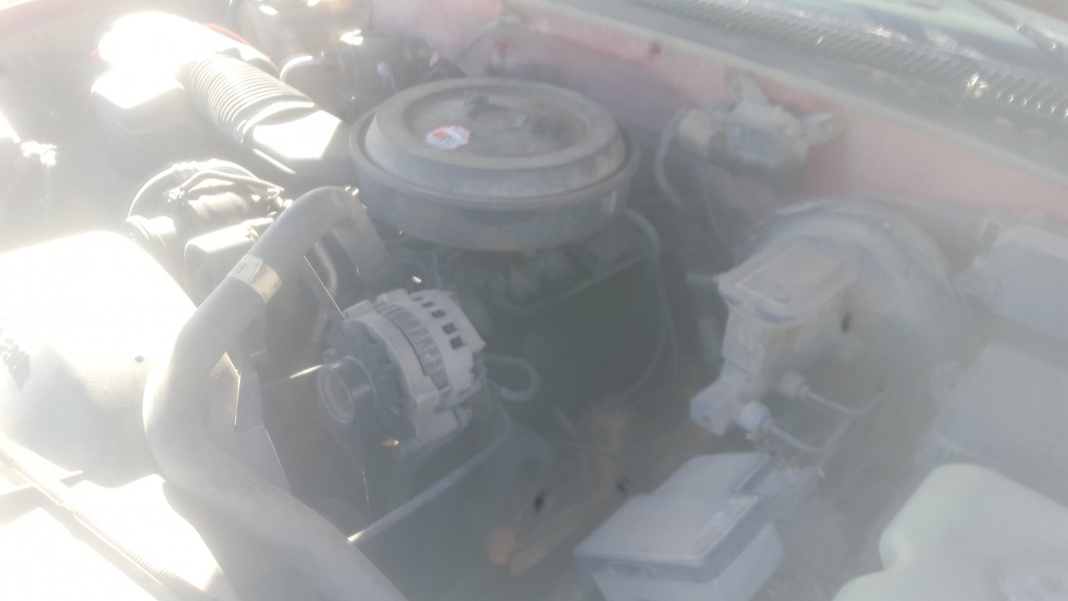

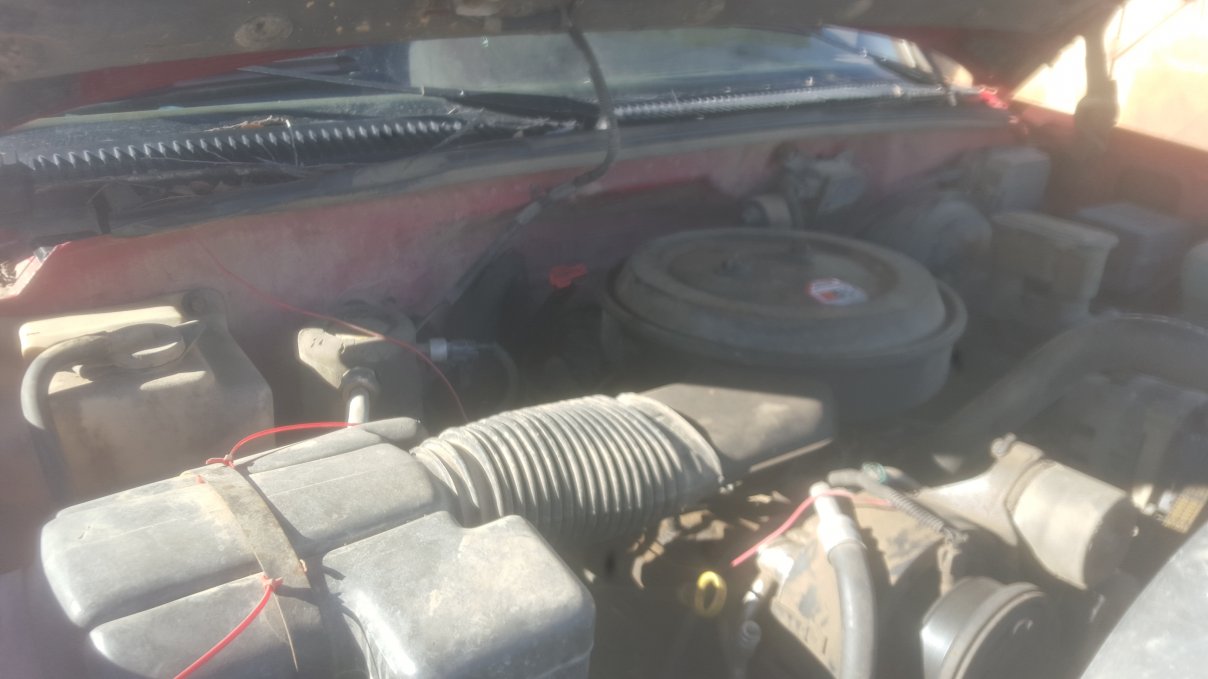

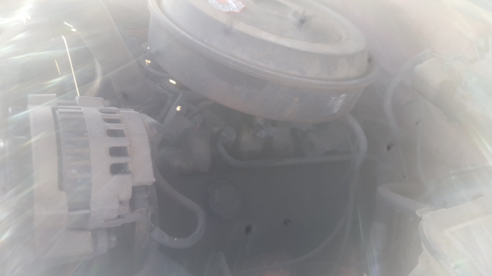

the pictures are kind of shotty sorry phone is partly broken. I counted 6 bolts on one side instead of 4.

That is indeed a TBI engine, are you sure your truck is really a 96? You mentioned title issues.

I understand it's on the third engine, but I can't see someone going through all the trouble of swapping the dash harness, fuel system, and engine harness to get a TBI into a Vortec truck.
FWIW, I daily drive a 95 GMC Sierra, that has the same interior as a Vortec truck, but a 350 TBI, because Chevy never bothered to update the TBI to OBD2, they just rolled out the Vortec.
