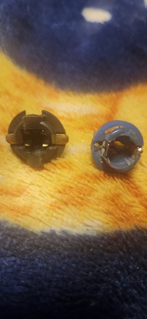

So.. I went to change some dash lights on my 1990 k5 jimmy. I noticed a few of the bulb holder pieces were messed up. I thought.. no biggie I have a couple spare square body instrument panels. So I pulled them out of my 1980's models.. and to my suprise its a different size, and crappier contacts. The black is the older type, blue is the new crap. Anyone have a part number on the 1990 blue one? I have like 20 of the older black style, much better design. Wont fit in the holes. Thanks

HF sells an assortment of small files that I use for modeling, maybe you can make the black style fit.

I think Dorman has dash lamp sockets in a variety of sizes.

I should've known that the 90 is a bulb and socket in one.... years ago. Like over 10 years ago I put leds in those blue things. Had to snake the light contacts in and around the metal contacts. It wasn't the greatest... and they flickered once in a while on certain bulb locations. I tried filing one black one down, but no ways that's working. So, anyone have a bulb number or better replacement?

Right on! Thank you guys for that. What was gm thinking? Lol .. for two more model years? If you have the newer semi electronic version with electric speedometer, daytime running lights , and any earlier model on the bench side by side. They look basically the same. Same weird ass printed circuit board. Different holes and bulbs.. Now I know something more. I have an 83 cluster with tachometer in my older truck. I parted a 1987 4x4 out that came with a tbi motor. Had a weird extra sensor that read the speedometer, because it had a mechanical speedometer. Weird little things they change. Thanks again for expanding my knowledge!
