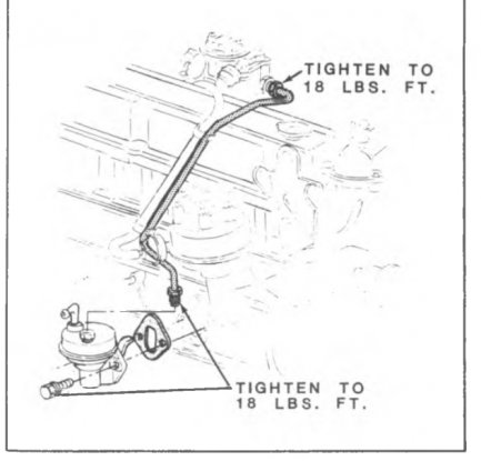

Here is a snip from the service manual. Exactly what mine looks like.

That's how it should be mounted. It mounts like that on a 292 as well.
Here is the normal set-up:
And from the GM parts manual:
Notice also, that these engines don't use a push rod between the cam and the fuel pump actuating arm. The face of the arm rides directly on the cam lobe and is reinforced:
Can it be installed either way?
I'm not sure but, I would say no. Even though it will bolt up if installed with the fittings on the bottom, will the arm be positioned correctly - in relation to the cam lobe? I don't know.

Yep, 194-292 are on top and can only go on one way..

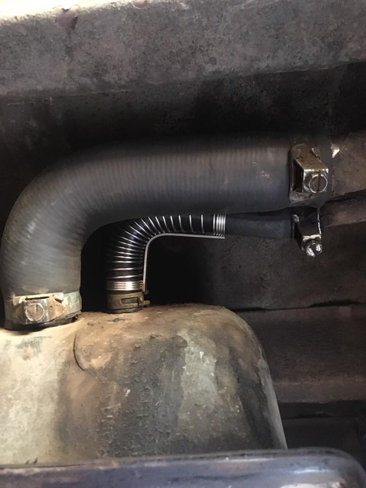

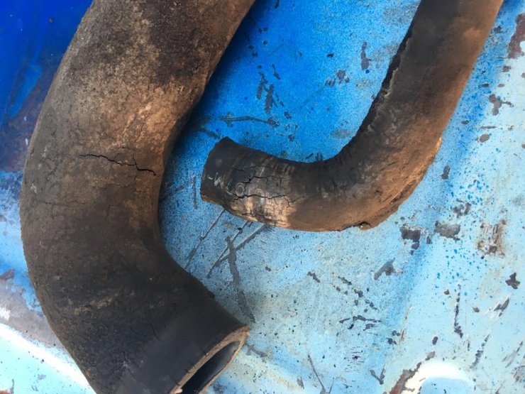

I filled the gas tank the other day and saw a stream of gas coming out from under the gas tank. When I start pumping it starts running, and when I stop it does. I suspect that the rubber fill tube has degraded from sitting so long. Looks like more work.
Yep, may as well replace the vent hose too at the same time..
