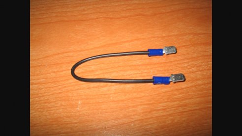

Somthing like this with some silicone to seal it up if you wish.

This is what i have done as well.
i think i am going to just jumper the plug that fits over this sensor. The fact that the choke is going to be engergized while i'm cranking the engine is of little concern to me because it doesn't get THAT cold here and the engine starts pretty quickly anyways even with no choke. So those few seconds really aren't going to make a big difference.
Whays wrong with choke being powered while cranking no diffrent than any small engine correct?

So anyways, i did end up jumpering the 2 prong plug and everything works great.
Now, would anyone know where i can get the little white plastic plug thing that plugs into the choke coil. Mine either broke and fell off or just fell off. The metal clip from the power wire that connects to the choke coil is still intact, but the plastic "cover" isn't there.
i feel that it will be more secure with this plug thing.
