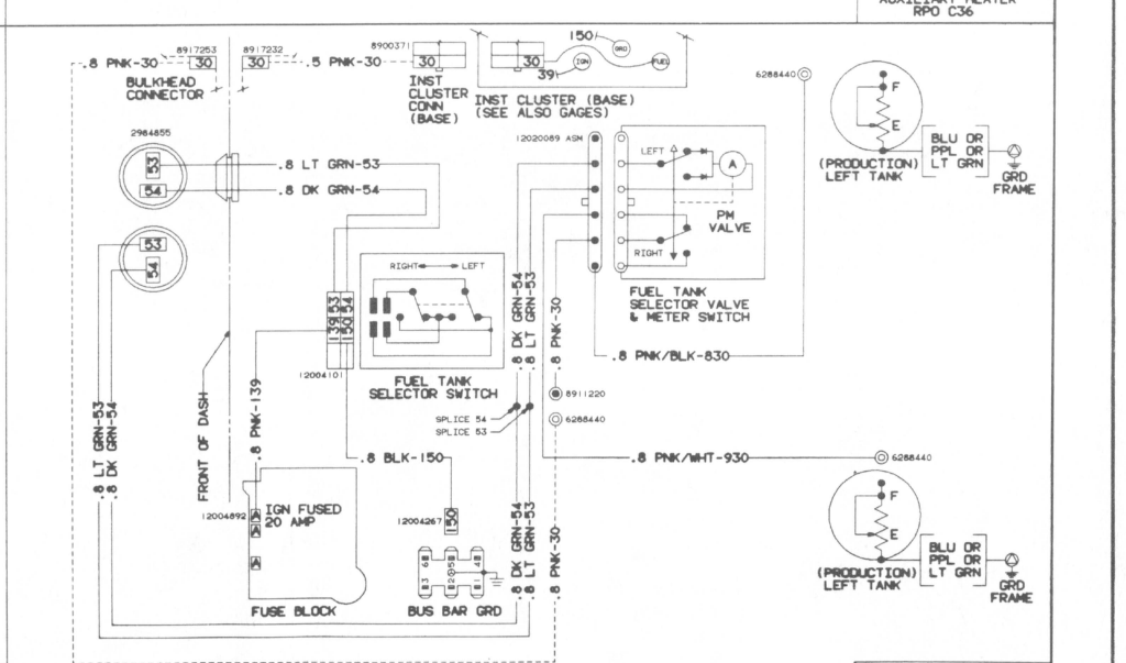

This is for an 84 and it says you need to trace the pink wire, but I believe the wire coming out of the back of the fuse box is a pink with a black stripe. It goes to the gauges first then feeds the switch valve circuit. The short must be between the fuse block and the gauge cluster.

yep- pink/black wire that goes to a lot of things. I'm currently chasing down the same problem (mine is random and doesn't happen often- which makes it difficult to find). I've traced mine down to the convenience center so far.
