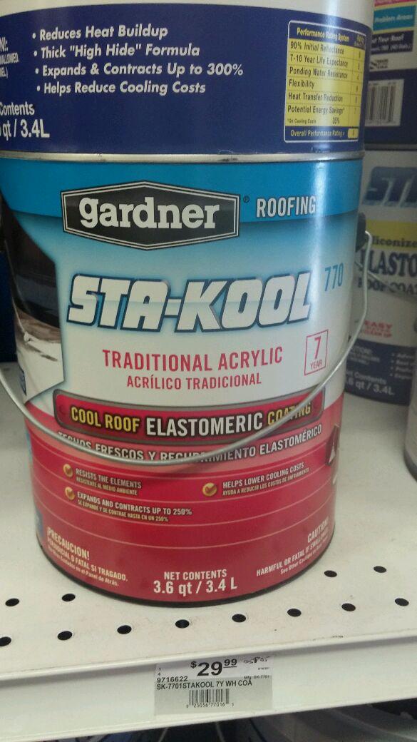

likely custom I am putting up new insulation on top, haven't figured out if I want it stuck to the roof like the floor due to heat and gravity over time or just lay something on the back of the headliners as insulation like carpeting insulation or something. as for cover material I have actually had good results with jersey fabric a few times but im not sure what I want yet. Honestly if it didn't turn into a microwave in the summer id leave it down, but without it the temp sky rockets. I may throw on some of that specialized reflective or sun paint on the roof, my brother manages a paint store and has something interesting I may go look at and since I can get a deal I figure why not and its supposed to help lower ambient temps by like 7 degrees I think
here I got a pic:
