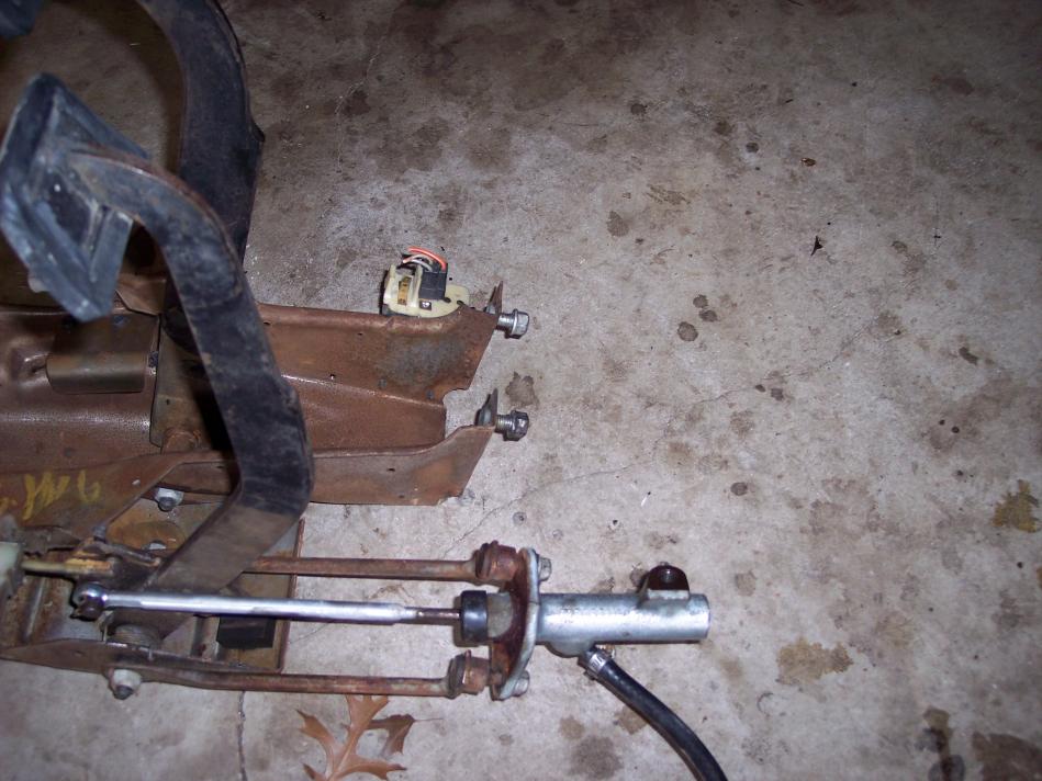

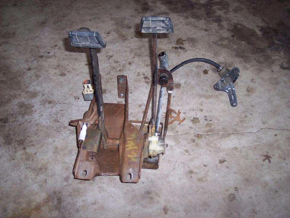

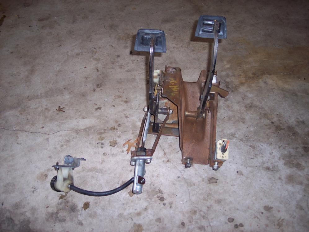

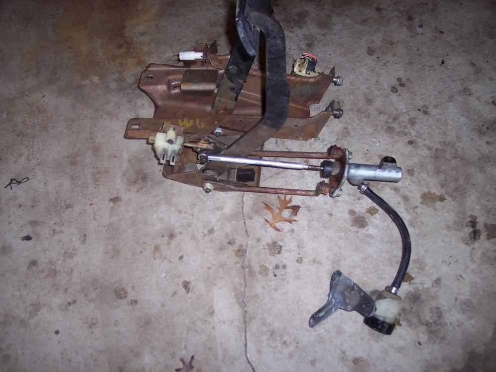

All I've got to help with...
Damn !!! :leghump: That's all huh??? Just missing the hose and slave. Big whoop. I'd want that new anyway. The pedal pads are even in good shape. Damn !!! :drool:
I like those strut support rods to the master. Great design. I have seen firewalls blow out before. That won't happen with that design.
