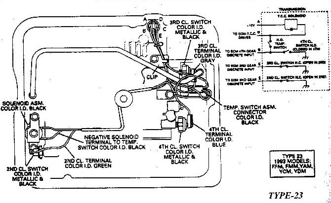

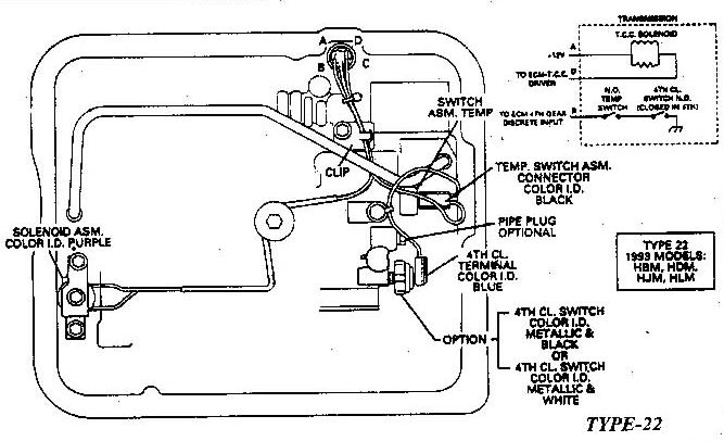

Depends on the year model of the 700r4. You can only get lock up in 3rd or 4th and many models are lock up in 4th only. There are pressure switches in the transmission on the valve body. Those pressure switches detect when you get into a certain gear and have to give the go ahead for lock up to happen. This is how you avoid lock up in 1st and 2nd. If you decide want lock up in 3rd also, you'd have to look at your valve body to see if it is tapped where there is a plug in the 3rd gear switch area and plugged. If it's got a plug in it, then you can pull the plug, put in the pressure switch and wire it in with the loom or best to get another harness, then you can have lock up in 3rd also.
Here are 2 different wiring examples. One will allow 3rd gear lock up, one will not. And these are ECM controlled TCC units. Both diagrams are from 1993 models.

Probably need to install another relay, hook a switched wire beyond the CL switch in the pan.

BTW, you can add the 3rd pressure switch to your manual non ECM set up and wire it in and still have auto lock up in D. (If the VB has the provision).
