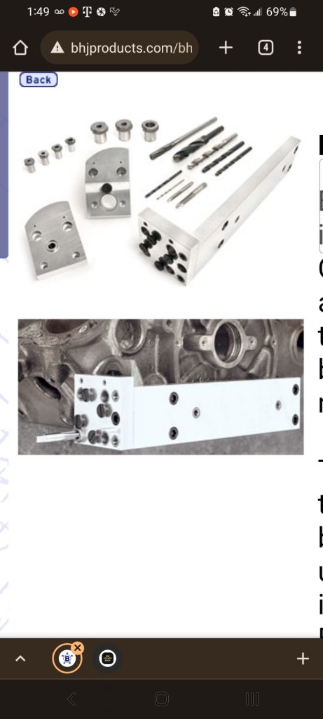

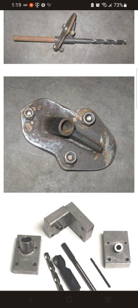

Tools for drilling sbc fuel pump pushrod. Jigs Ive found on the internet for anyone that wants to try drilling a fuel pump rod.Turns out its hit and miss on how later model blocks were finished ,so the jig that works for 1,may not work on another.It seems some have bolt holes and a partially drilled push rod hole,some have bolt holes but no pushrod hole at all some have no bolt holes or pushrod hole. That last jig locates on the timing cover pad.All could be fabbed using a bare block with the pushrod hole to reverse engineer the pushrod angle and bolt locations.The L shaped jig for drilling the bolt holes could easily be fabbed using a piece of steel strap approx.3 inches longer than the aluminum pictured with a 3x3 piece of angle welded or bolted to it. The jig for drilling the push rod hole is self explanatory.

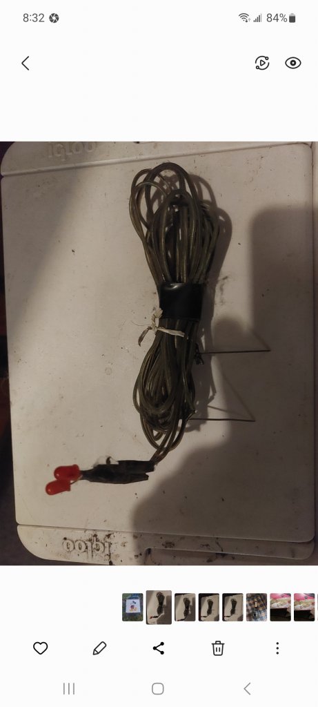

Okay,I've talked about this before but finally got around to taking a picture. That's a homemade noodles light/test light. That's about 12ft of 2 conductor speaker wire,2 leds twisted in opposite polarity,remember leds are polarity sensitive, they won't light if they get power reversed that's why two twisted in opposite polarities. 2 T pins. You slide the t pins in the backside of the connector you don't even have disconnect anything,string the wire somewhere safe and hold the bulb end down with the wiper blade. Now you can see from the drivers seat if you have a working circuit,you can even test drive for intermittent problems. If I had been thinking I would have used 2 different colors,hooked it both ways and noted which light lit with power in which direction,so I'd know which side was power and what side was ground. Ignore the bread twist tie,it's just holding the bundle. I need 2 new LEDs and radio shack is gone,and the ones I bought from. Ebay are junk. Where do I go? P.S.. it's LED so it's safe for the ECM.
I get everything from Amazon... Something like this might be easiest. If you wanted a mini project, you can get the bare LED's and a handful of resistors and make a Christmas Tree style light that shows you if you have 4v, 9v, 12v or 14v (I'm just throwing out some levels that might be useful) and which polarity it is.
I've rigged up similar setups but it's always been temporary. I ought to do like you have here and make a permanent tool. Good idea.

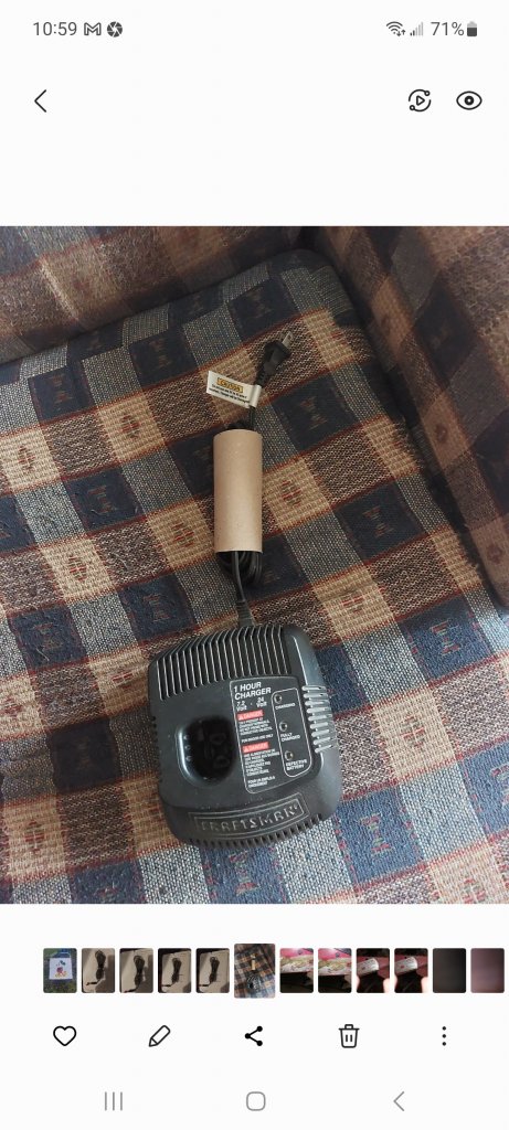

I was putting a charger up the other day and didn't know if everybody knew this trick. You could use napkin rings or short pieces of pcv but the toilet paper tubes are fancy enough for me. I like it cause I can just pull the cord and I've got it ,and putting it back up is easy,no looking for tape,no having tangled cords next time you go to use it.
