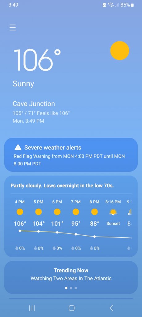

I'm sure it's hotter elsewhere but 106° is Hot for around here!! Gota love August
Yep, same thing over here on the other side of the mountains. Back to the 80's next week :)
Glad I got my AC fixed on the square. Just driving around town and she leaves quite the puddle of condensation under the truck, but its nice and cool inside! Now I just need to be back to being able to turn into parking spots with two fingers instead of it switching between no effort and Hercules every few seconds.
