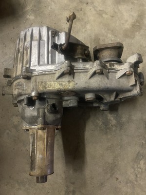

Good Morning,
I am looking everywhere for a NP241c with passengers side drop (88-92 Blazer and Suburban). I am in AZ and was wondering if anyone here had one or knew a good resource. Junk yards here, Craigslist and Facebook market show Zero near me.
Hit me up if you do.
Thanks!

Presumably this is for a LS swap, and to further dash hopes unintentionally, it's a 1990-1991 np241 you're looking for, with VSS
Edit: don't forget there's np208's with vss also out there. I think 1990 only?

Inaccurately listed, again, it's 1990-1991, but this is pretty on par pricing these days because anyone and everyone knows why an individual specifically asks for a pass drop side np241c.
They want that VSS signal so their transmission shifts and the speedometer registers for their LS and 4L60e.
Maybe you just want a replacement for your own, and I'm wrong, but lol 99% of the time the 241c is for a LS swap

I would recommend finding a cable driven 27 spline np208 from a squarebody if you're running a 4L60e.
The VSS signal can be obtain thru a Dakota digital adapter.

92+ drivers drop np241c
I have one in my 1 ton swapped s10 behind my 4L60e

Good luck finding one. You need 90-91, but you can use 88-89 IF you have the 90-91 center housing and the reluctor on the shaft.
Every time I see one, I grab it. Do not have any now.
