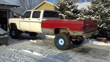

I have a 6 inch lift and 37s for my dd now and so far I found I need side steps t get in easier

How far is it from the ground to the bottom of the door and what's the roof clearance?

from the ground to the bottom of the door sill is 31.5" and the roof height is 84" (7')
