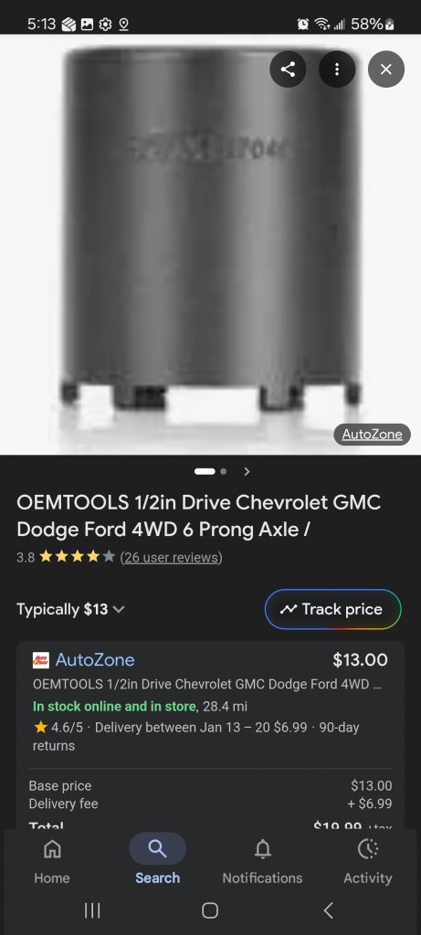

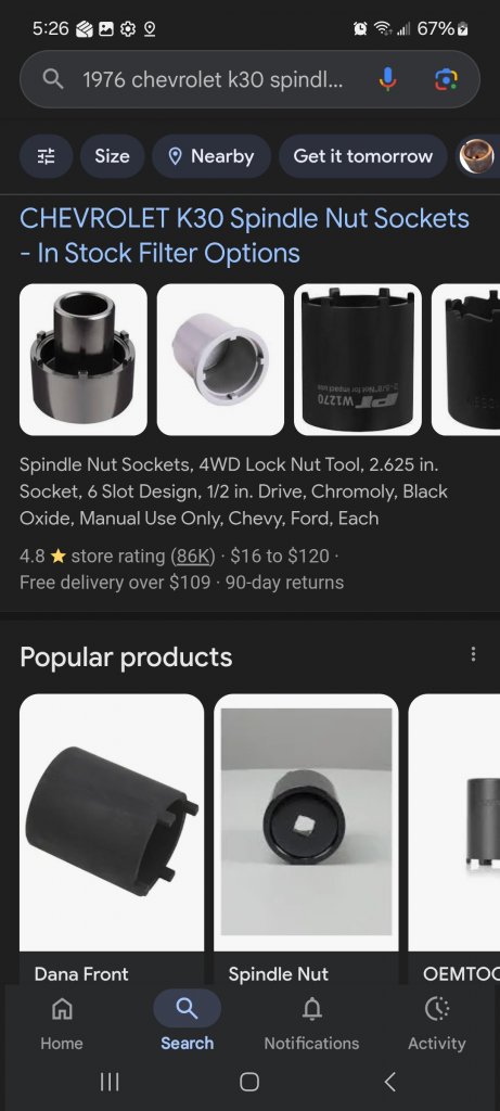

I don't think they are the same for all years. But look for a K30 rear spindle nut socket for your year. I think Hobo freight has an assortment pack.

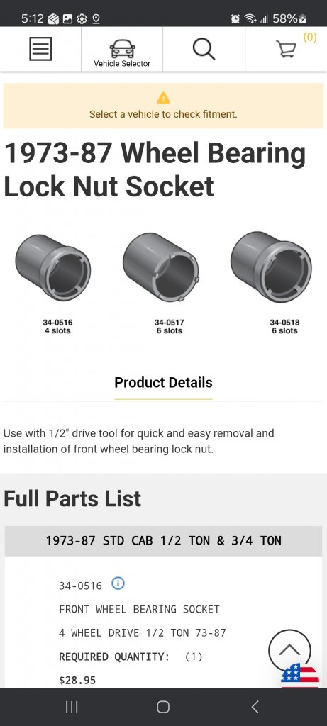

The pic that shows 3 pick out your,that's from lmc but use that to see if you can find one on Amazon or take that Pic where you buy parts and tools.

The pic that shows 3 pick out yours,that's from lmc but use that to see if you can find one on Amazon or take that Pic where you buy parts and tools.

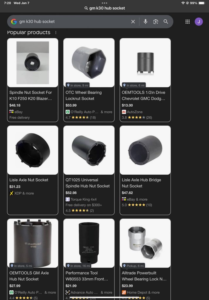

Here's a start on Google...

The type like the one I circled in this picture is very handy on the rear axle. The center sleeve locates into the spindle so you can really put some torque on the breaker bar without the socket being as likely to slip off.
