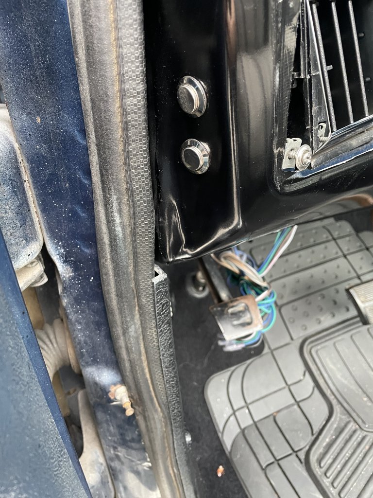

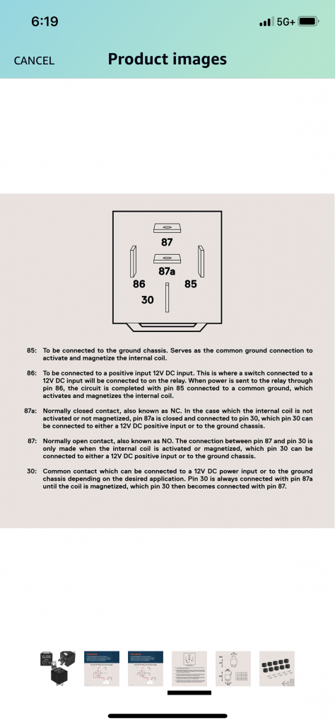

I'm about to put a kill switch on the starter wire (PPL-6) under the dash. I was trying to figure out if there was a way to hook it to the horn so if someone tried to start the car the horn would honk. The problem I run into of course is the horn is activated by closing the ground (BLK-28). Any ideas? In the past I thought I read a post about this, but I couldn't find it.
