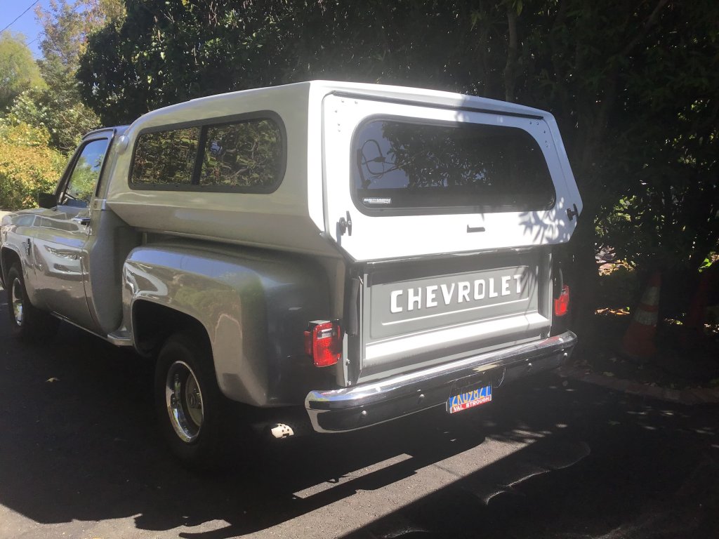

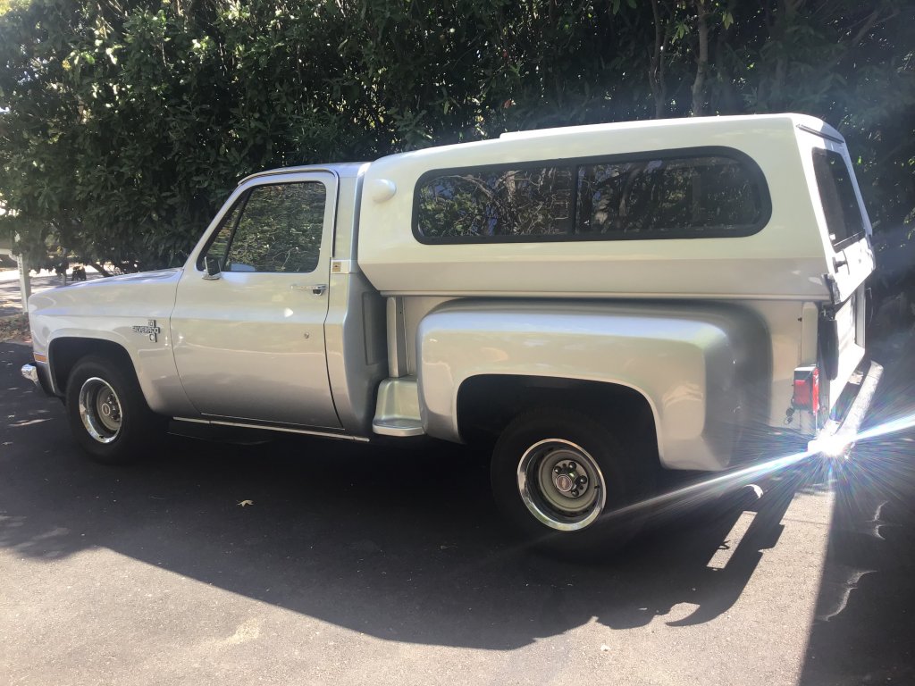

Original color was probably white, mine was. After considerable consideration I had it repainted white, probably single stage. Saw one painted the body color, didn’t look as good as the white, my opinion. Any other color combination would look as if it came off another truck.

Mine was originally body color according to the spec sheet in the glove box. Got almost all of the white off. Now need to try and brighten up the original tan. I’ll try some compound a polish if the roughness doesn’t tear up my buffer or wool pad.

Last pictures looked remarkable! And BTW, typically don’t see the top

It’s better than the flaking / peeling white that was on it but is blotchy in spots. I bet it is gel coat. I’ll probably just run it like this for awhile. If I get it repainted I’m afraid of it looking too new of paint to match the original metal paint that 40 years old on the rest of the truck. I hit it with Meguiars finishing polish 205 which didn’t do anything to the topper but brightened op the paint on metal part of truck.
