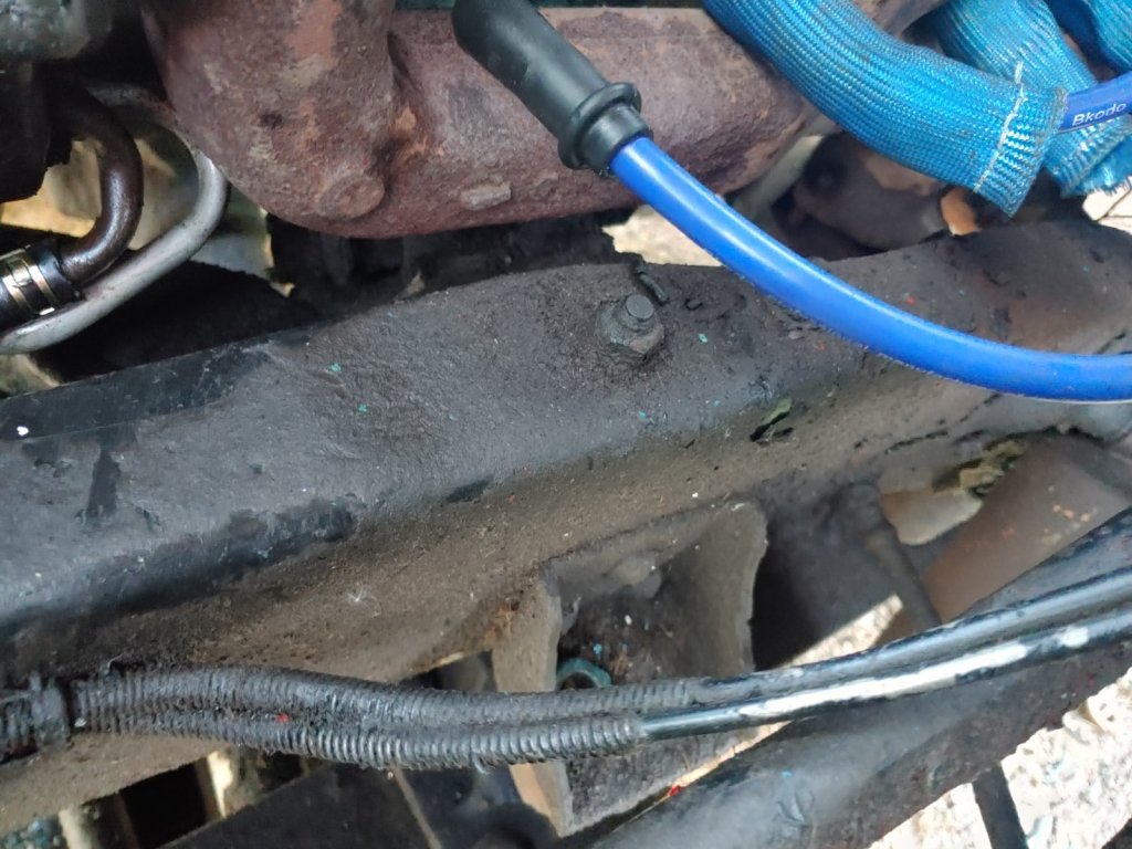

Tell us those frame horns ,youll find a lot
The front crossmember being solid vs having holes also tells a lot (the rounded frame horns you can look at your other 70s trucks vs your 87 to see what i mean

I assume the picture you sent is what I’m needing a photo of? I’ll go take one
I accidently sent it apart of my message, but thats a shot of what the frame looks like on my c6p 1980, so it should look reasonbly similar if yours is ideal
