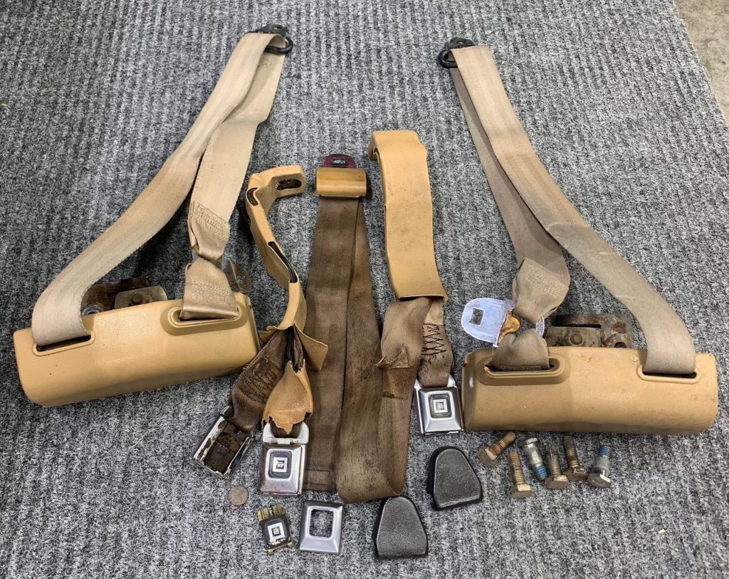

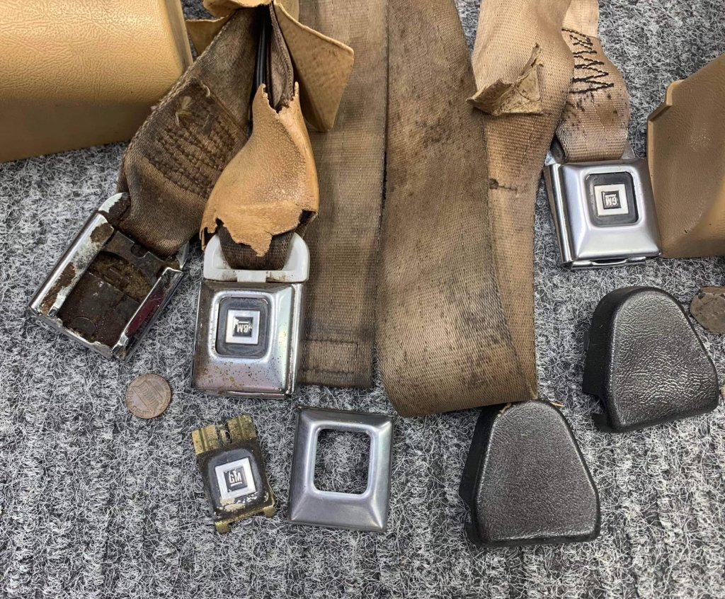

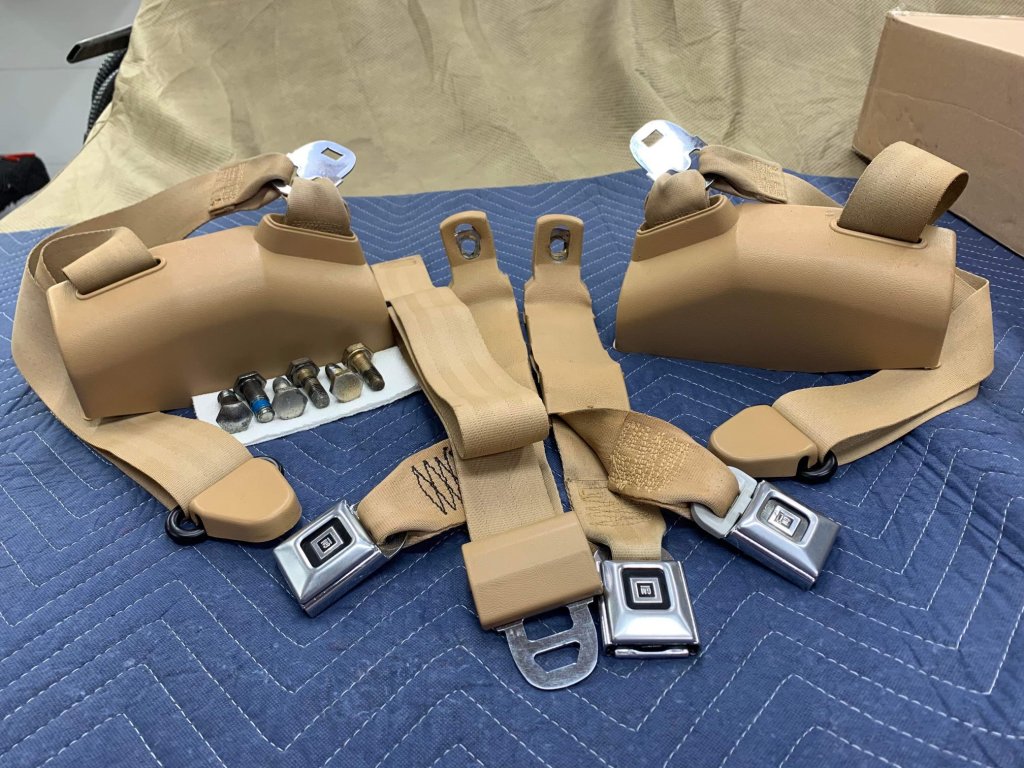

Tina King on FB restores seatbelts. She would be able to answer any and all questions you have. This is a set she did for me.
