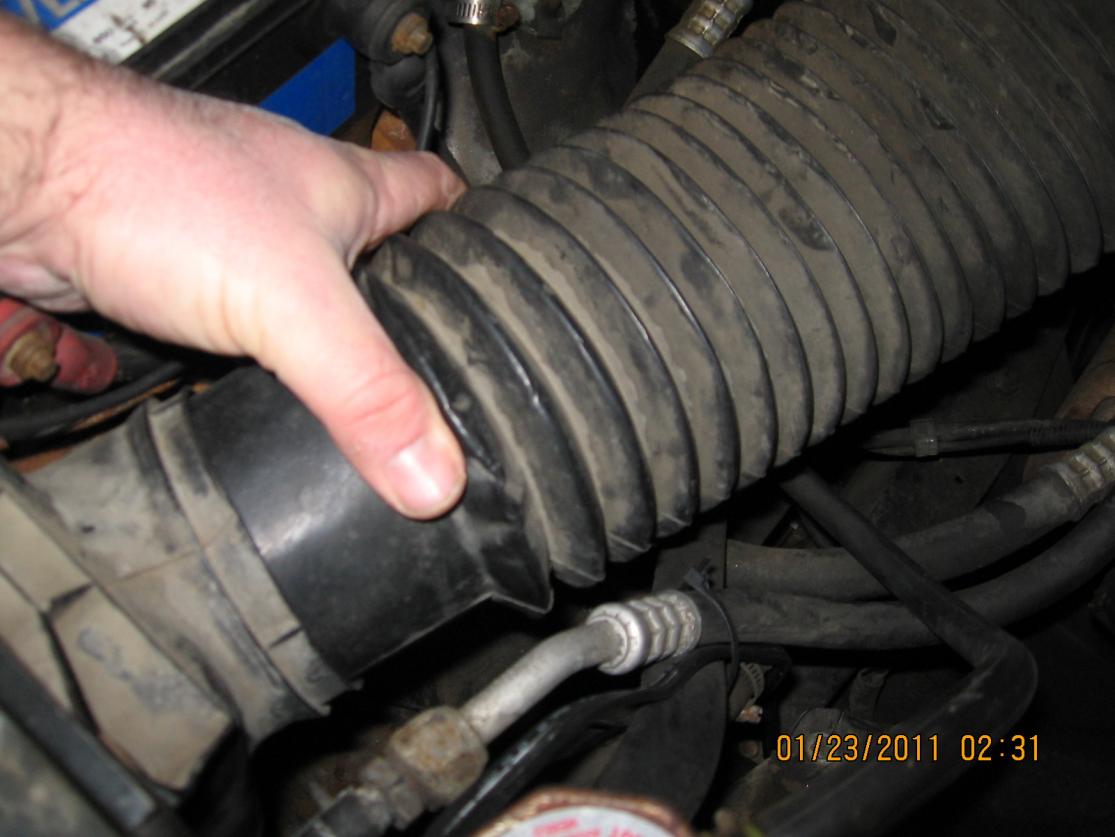

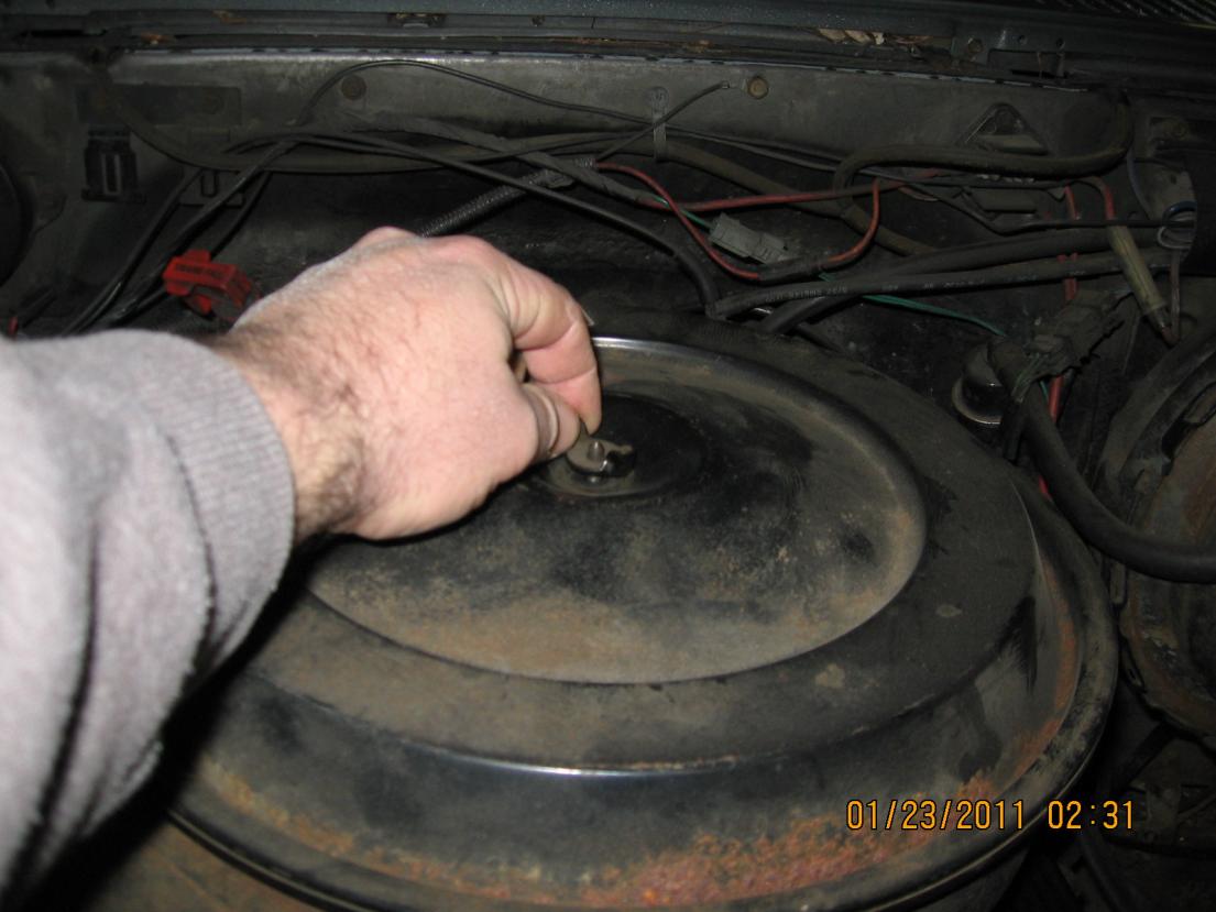

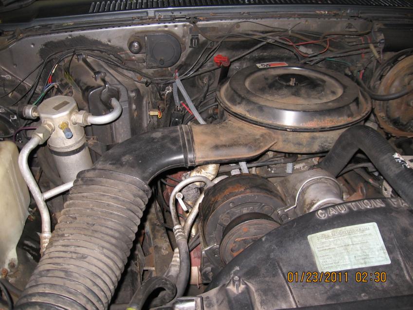

Intake gasket r&r
Remove air filter assembly. Wing nut on top holds everything on. Be carful with stove pipe under snorkel, older ones can rip and break/bend very easily. Pull intake tube out from port on radiator support and remove. I also removed the threaded rod going into the throttle body for the wing nut so it's out of the way.

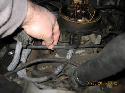

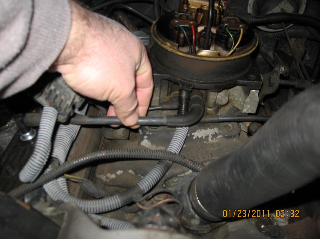

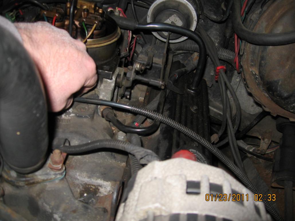

Next, remove PCV Valve and EGR module vacuum lines. They both are on the front of the TBI and shoot to the pass side valve cover area.

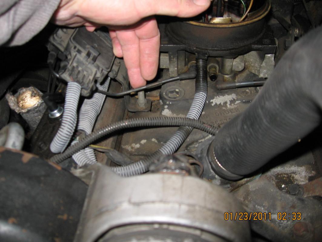

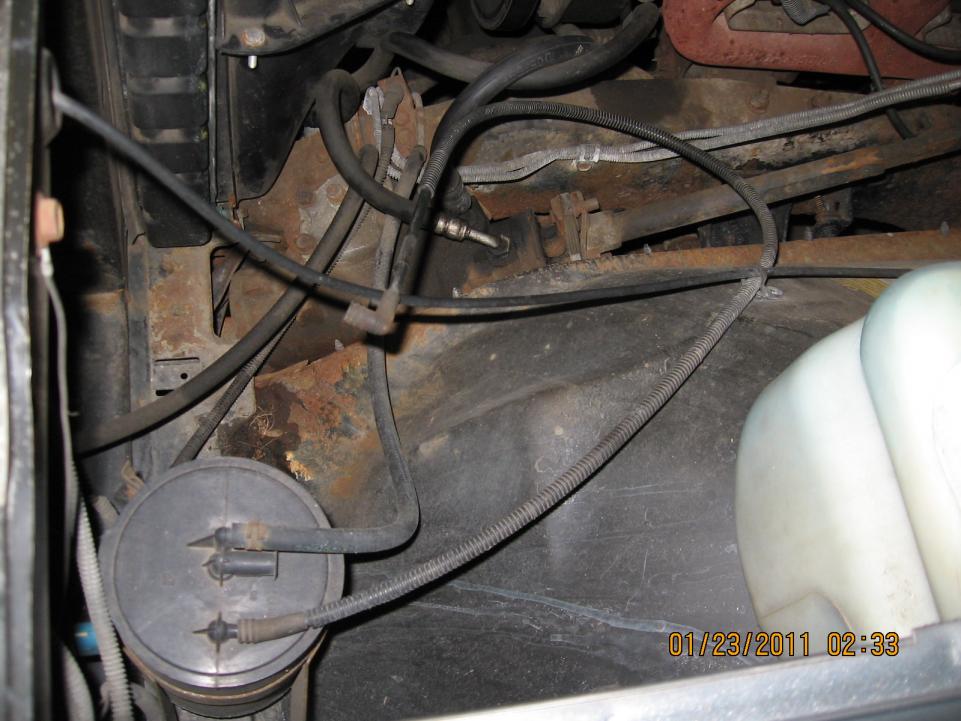

Next remove charcoal canister vacuum line. It is also on the front of the TBI and shoots to the drivers side radiator support area. Just curl it and stow it out of the way.

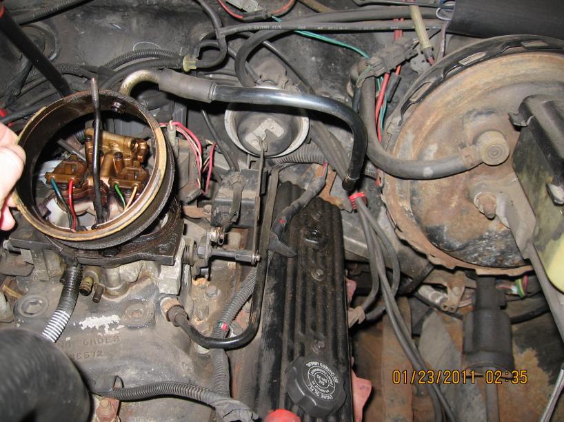

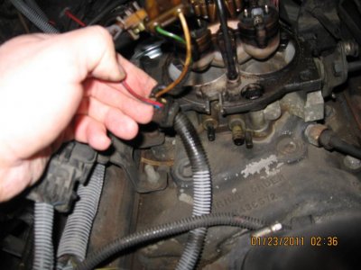

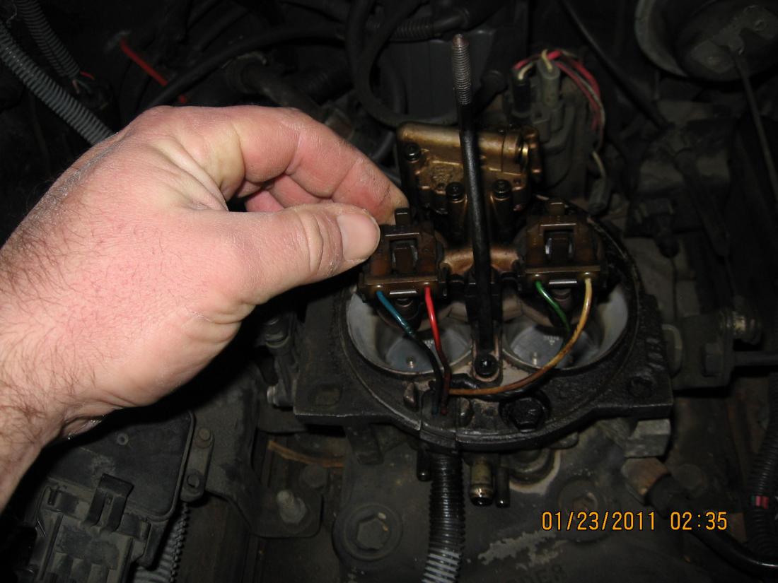

Next unclip the 2 fuel injector plugs. Again, be carful how hard you squeeze the tangs on the plug to remove it as they are very brittle and can crack. As you can see the wires run out of the TB thrugh a U shaped rubber grommet. Slide the grommet out of the TB housing.

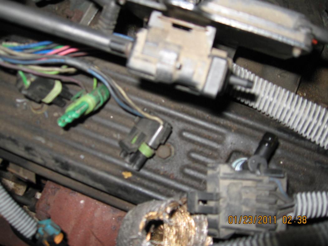

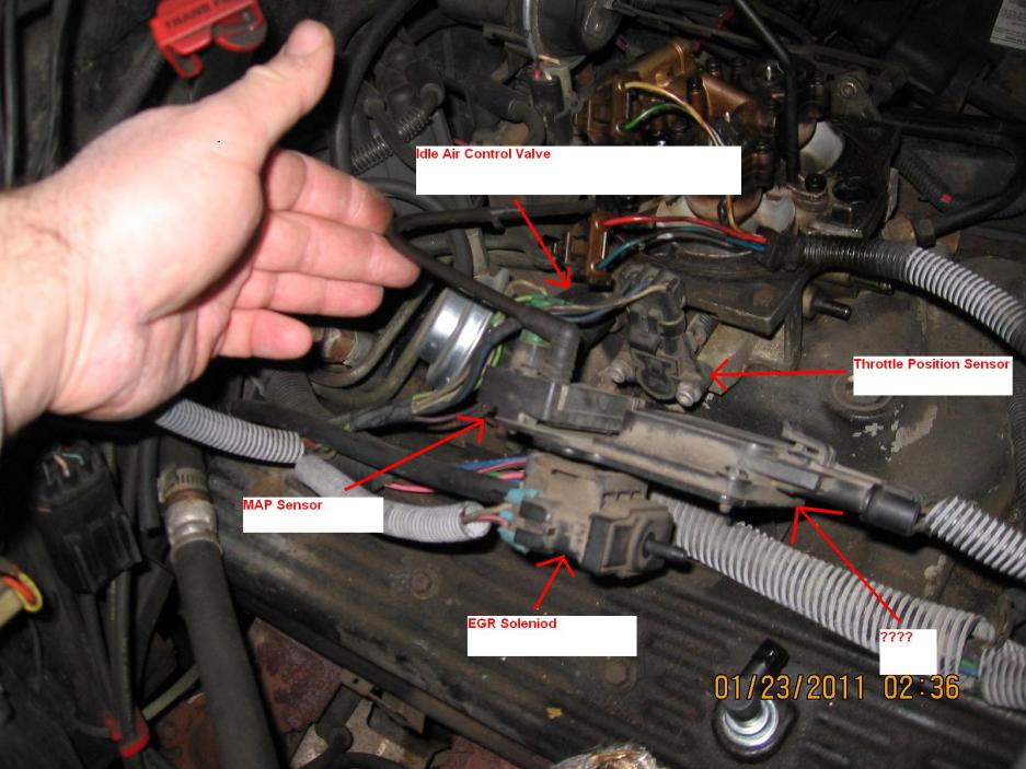

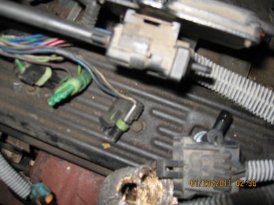

Next remove all plugs from the TB, MAP Sensor, TP Sensor, EGR Solenoid, IAC Valve, and other module.

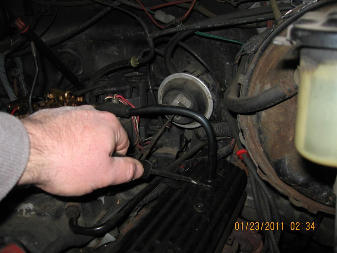

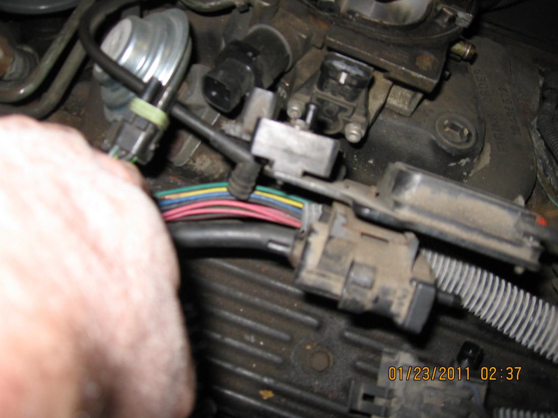

Next rmove solenoid to EGR vacuum hose and MAP sensor to TB vacuum hose. MAP sensor hose hooks to TB in upper rear of unit.
