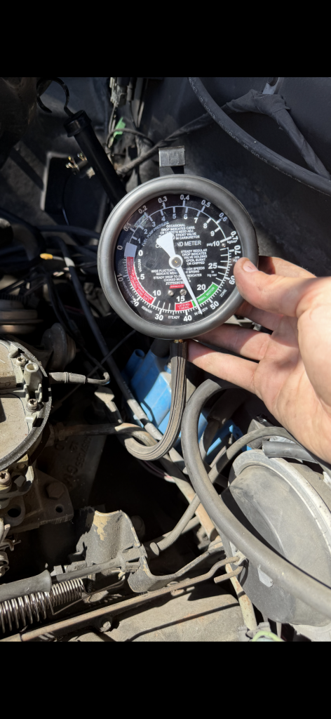

I'm guessing 49 states. Still has a qjet carbureator? Put a vacuum gauge on manifold vacuum,check your reading,disconnect and plug the AC vacuum line see if the reading is the same,it should be.

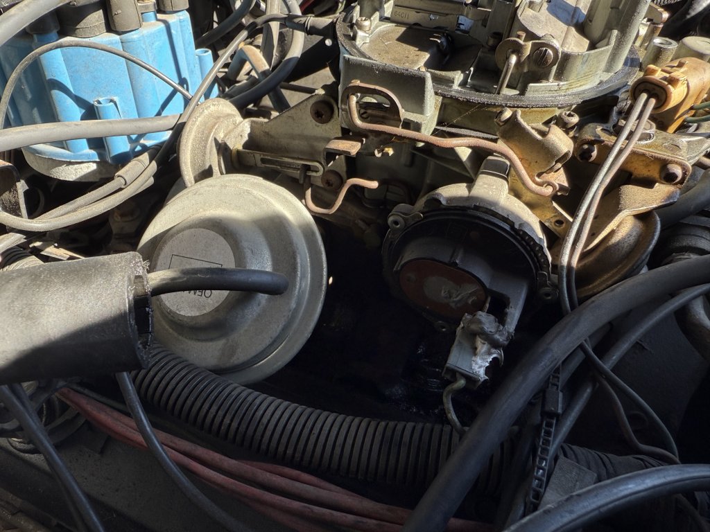

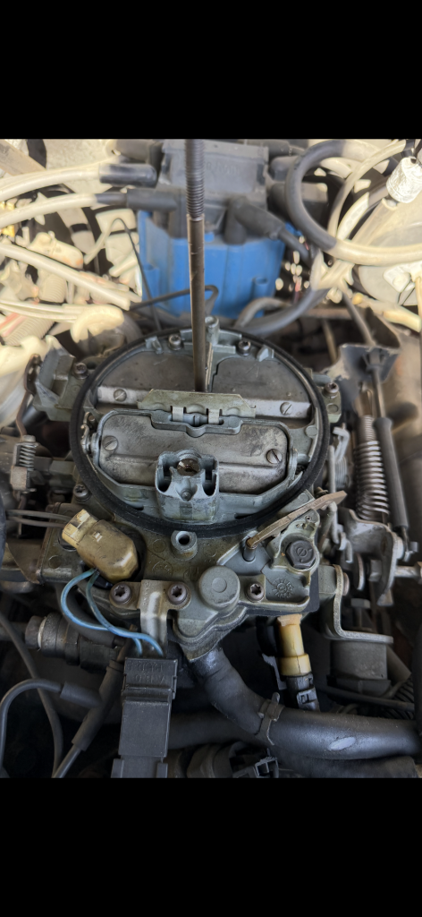

It’s a CA truck. I decided to undo what I had done to stop the rough idle, So i disconnected the ac vacuum line and reconnected the cc servo as it originally was but now the rough idle remains. Im at a loss. I’ve attached some pics. I believe I have an electric quadrajet carb. Electric choke cable was a bit melted but it was still activating my choke. Could it be possible that the moment I connected my ac vacuum line it threw off my carb mixture and/or timing off? Engine Vacuum reads Normal as well. Any help is appreciated. Thank you
