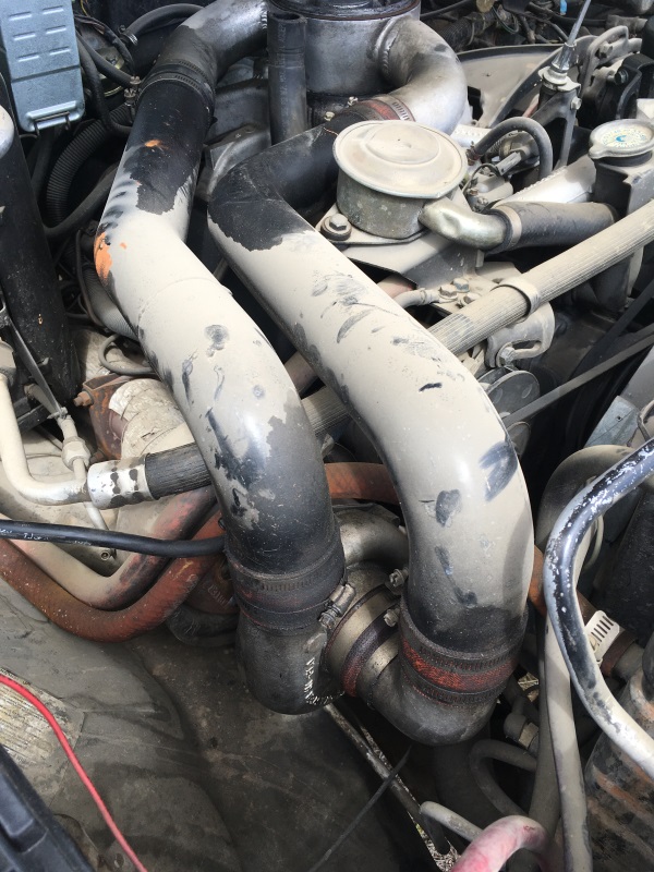

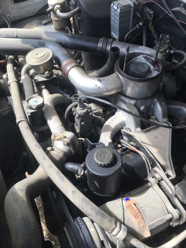

I got some pix today under the hood of the 84 k30 diesel with turbo. No documentation, just a 30 year old ad clipping stating it had "new 6.2 turbo, trans. & transfer case" at the time. No idea if "new" meant he (next to last owner) rebuild what he had or completely swapped out power train and if latter then were those rebuilt or what. So any tells, distinguishing marks etc to ID what exactly is under this hood could greatly help with TLC going forward. Is it a Banks turbo conversion? Was a later GM 6.5 turbo somehow mated to the original 6.2? I'm keen to sort out what I'm starting with.

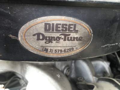

...There is this sticker on the air filter housing but that company seems to have vaporized a quarter century ago.
