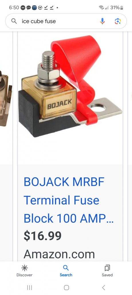

This thread is supposed to show what can go wrong and how anyone without a clue can make a wiring mistake.
It also shows how a person can write a review showing exactly how he screwed up and hasn't a clue what he did wrong.
The story starts out with a link for a reliable Eaton Fuse Holder.
The gentleman is complaining, after installing this Eaton Fuse Holder.
Here's the sales page with customer comments and pictures:
https://www.amazon.com/dp/B07LC5VBPD/
In the customer reviews, he slags the part for "not doing it's ONLY JOB".
QUOTE:
"It had 1 job... and failed.
I don't ever write bad reviews, but this almost burnt my boat down last week.I bought this product 12 months ago and it only had 1 job... Unfortunately it melted running approx. 200amps... I only gave it 2 stars because I'm sure it works fine with a 100A fuse, but obviously not capable with a 300A fuse." -Amazon customer review
Take a closer look at the picture, as to why this is seriously NOT funny.
Notice the chunk of copper (looks like a washer) UNDER the fuse, directly connected to the feeder and not between the fuse?
That is the copper crimp lug to the load.
Notice there's nothing except the standard washer and nut over the top of the circuit?
That is NOT where you put the load across the fuse.
The load must be located ON TOP of the fuse, in order the fuse works as engineered.
Right?
This is what happens when "operator error" gets mixed up and turns into a bad review.
What this picture shows is gross negligence.
His insurance company would have denied his claim and he would have been out the entire cost of replacing or repairing his boat.
Please triple check your wiring.
Test for load impedance (ohms) and voltage BEFORE you write a bad review and post pictures of your negligence.
In order to any fuse to work, it has to between the source and the load.
Any questions?

Sometimes you need to be a detective to fix a problem someone created. I can clearly see the copper lug you speak of and it does not belong there. The top stud where the load should be connected shows no heat load.
7,713
13,730
Auburn, Washington
@RanchWelder
Yes. That appears what happened. No need for the others to argue about it.

@RanchWelder taken at face value, you threw the first stone. Even if ricko was stalking your posts in order to troll you, his question, I feel ,is as valid as it would have been Had I asked it. Because at first glance I dont see the issue, but upon reading your post a couple times and using the visual aid ricko posted, I was able to finally understand fully. I think if you had posted arrows in the photoo or if you had posted the product listing / instructions it would have been much clearer to see.
basically the man added a lug connection inline his power supply with a branch 300amp fuse leading nowhere.
Surprised the fuse failed, he angrily gave 2 stars and a bad review.
