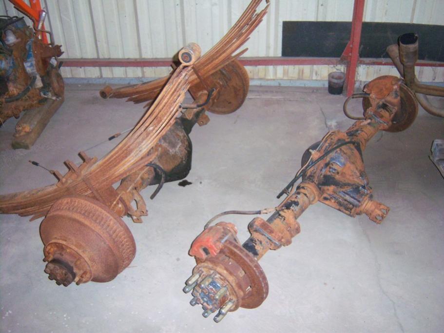

I was thinking it was about $500-$600 overpriced too, but after realizing it was Detroit Locker rear end and LSD front D60, Its probably more like $300-$400 overpriced. Most of the CUCV set ups are open D60 fronts.
You guys don't even want to know what I paid for my CUCV 14ff w 4.56, Detroit Locker and had a disc brake conversion on it.
47,924
11,167
Finally I found the pic. This is my CUCV 14b FF w 4.56 and DT Locker that had been converted to Disk brakes. I bought it for $150. The other one with springs and drum brakes, was a FREEBIE for hauling it off. Its an open diff 4.10 rear end.
