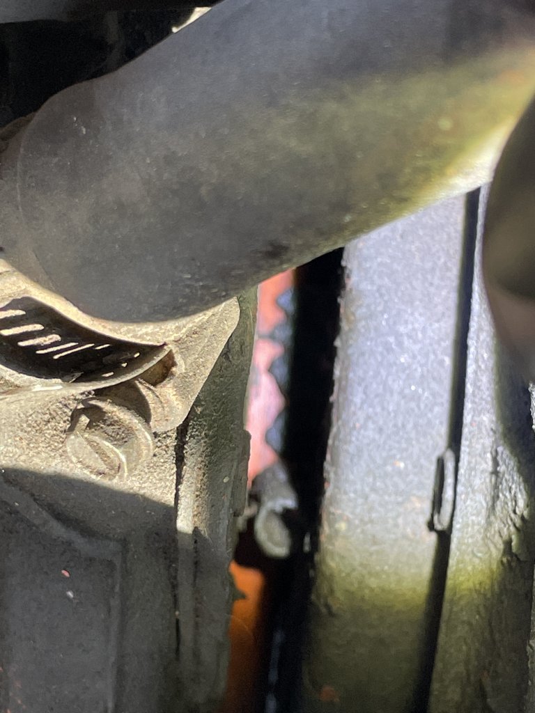

Sorry for the blurry photo but which of those points should the line be at? I just want to make sure I have it set up properly

You are still advanced a few degrees before TDC, but close enough to reference for the rotor position.
Pull the dizzy cap off and see if the rotor points in the general direction of #1 cylinder itself, or does it point towards the firewall.
