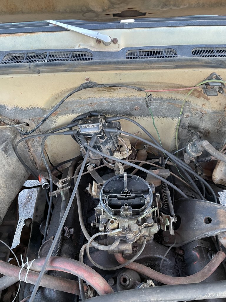

that is the vacuum advance right?

A couple things stick out to me.

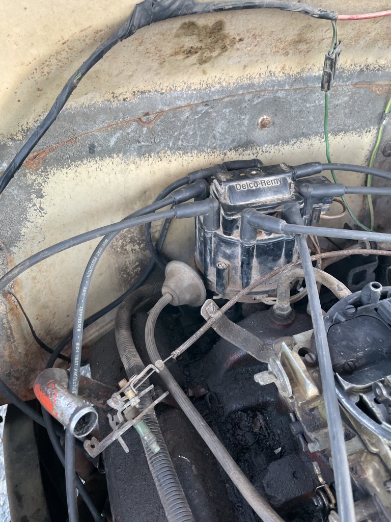

The vacuum advance seems too far retarded from what I am used to seeing.
And if the timing is late, that will affect starting and running.

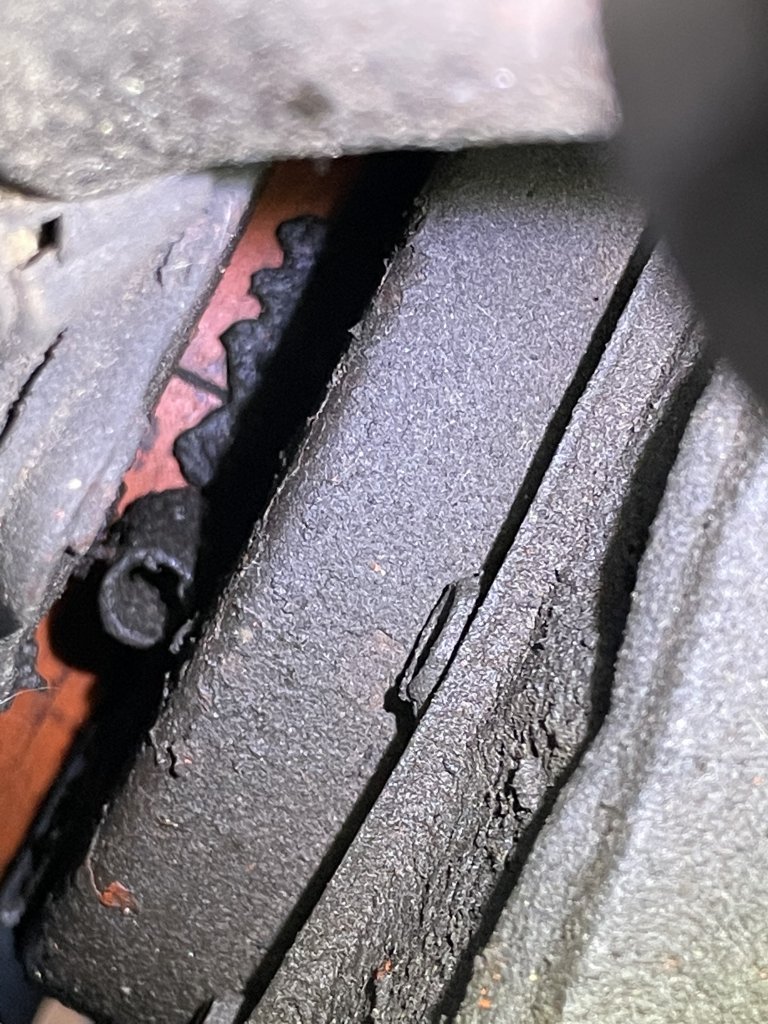

In your pic, the rotor is pointing to where #8 normally is.
Try putting #1 wire there, and follow through clockwise with the rest of the wires and see what happens.
Also, the rotor doesn't look too pretty either.
Here's a pic of how the wires should be with a "correctly" indexed distributor.
Would you be comfortable to pull the distributor and re-index it if necessary ?

I found that same image a few days ago and the wires get pulled super tight and one or two of them won’t even reach from distributor to plug. I started with number one where the rotor is about to be. Should I try moving them all one spot over and see what happens?

I have found it's better to start with the longest wire first, #2, then work my way with the next shorter wire.
Yank all the wires off, and go from longest to shortest.

I finally got it started!!! I’m not sure what I was expecting but it was definitely not to make myself deaf just by sticking my head under the hood with it running. Now I believe all my issues are the oil leaks from everywhere. I saw your reply after the fact but I moved all the wires one spot counter clockwise but will redo them if it doesn’t run well when I go drive it tomorrow morning because I did notice a few things I forgot to put back in place when I replaced the clutch last year

If it wasn't for the pic I asked for showing the position of the rotor when the harmonic balancer said it should be pointing at #1 or 6, we would still be trying to figure it out.

Also, verify your ignition timing (as I noticed the position of the advance unit) if the timing is running late, that causes more heat plus reduced fuel economy and loss of performance.
