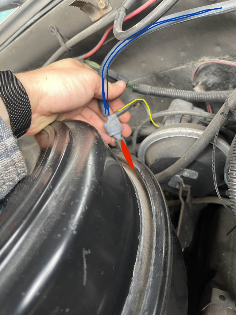

I promise this is my last question on this issue lol. I’ve been trying to understand the diagrams but the CC servo diagram throws me off. I am trying to figure out where to attach my AC vacuum line. On my current system
Blue line goes to Vac reservoir
Yellow line goes to Cruise control Servo
Red line goes to Intake
1. Can I Just disconnect the yellow line from the Cc servo and connect it to the ac vacuum line since I won’t be using CC?
2. Or can use a Tee connector within the blue line and connect the AC vacuum there?
Thank you for your help. god bless
