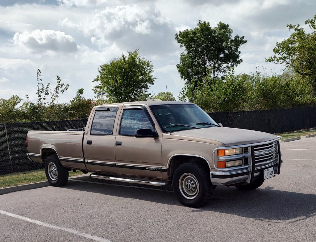

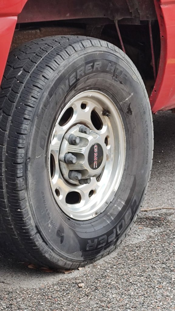

I think the OBS trucks are the first ones to have trim rings and center caps for 8 lug models. Then the NBS models were the first ones to have aluminum wheels optional for 8 lug models. Pics attached.....

I will also add that both these newer wheels will fit square body trucks, they're 16". The newer aluminum wheels through 2010 will fit the old style 8 lug pattern (6.5" spacing). 2011 and newer applications are a different, metric pattern and these wheels will require adapters.
