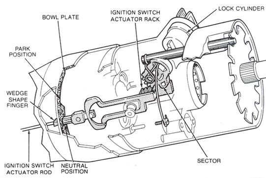

Spring installed with set screw.
Full lock, key in accy.
Key in wheel unlock.
Unlocked, key in START.

what about the issue of the key getting hard to turn in the start position? in my shitbox 85 the switch feels normal 95% of of the turn and then just as it is about to crank the engine, it gets a lot of resistance. i think the exact same thing started to happen to my uncle's 77 before i destroyed the switch with channel locks; i put a push button in that one.
