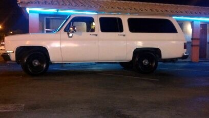

Thank You for this topic.
bottom two bolts fell out on my Burban other day.

:eek: That don't sound good.
Welcome to GMSB. Nice Burb. You can skip the Into thread if you want. How about starting your a Under Construction or Project thread.
