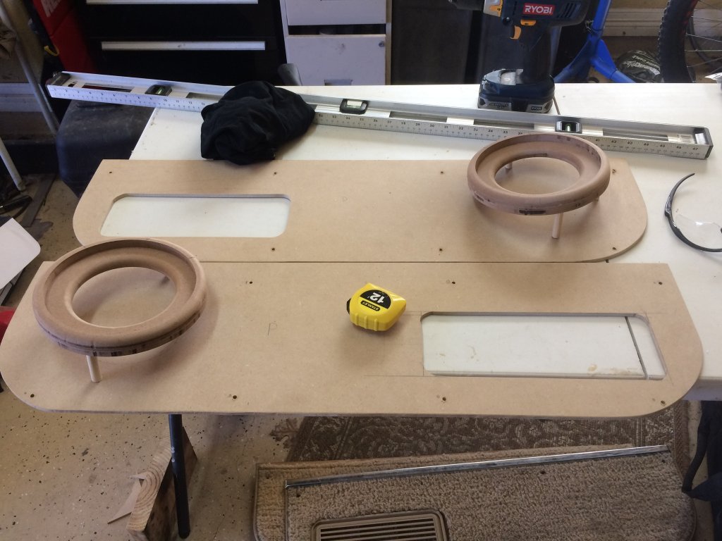

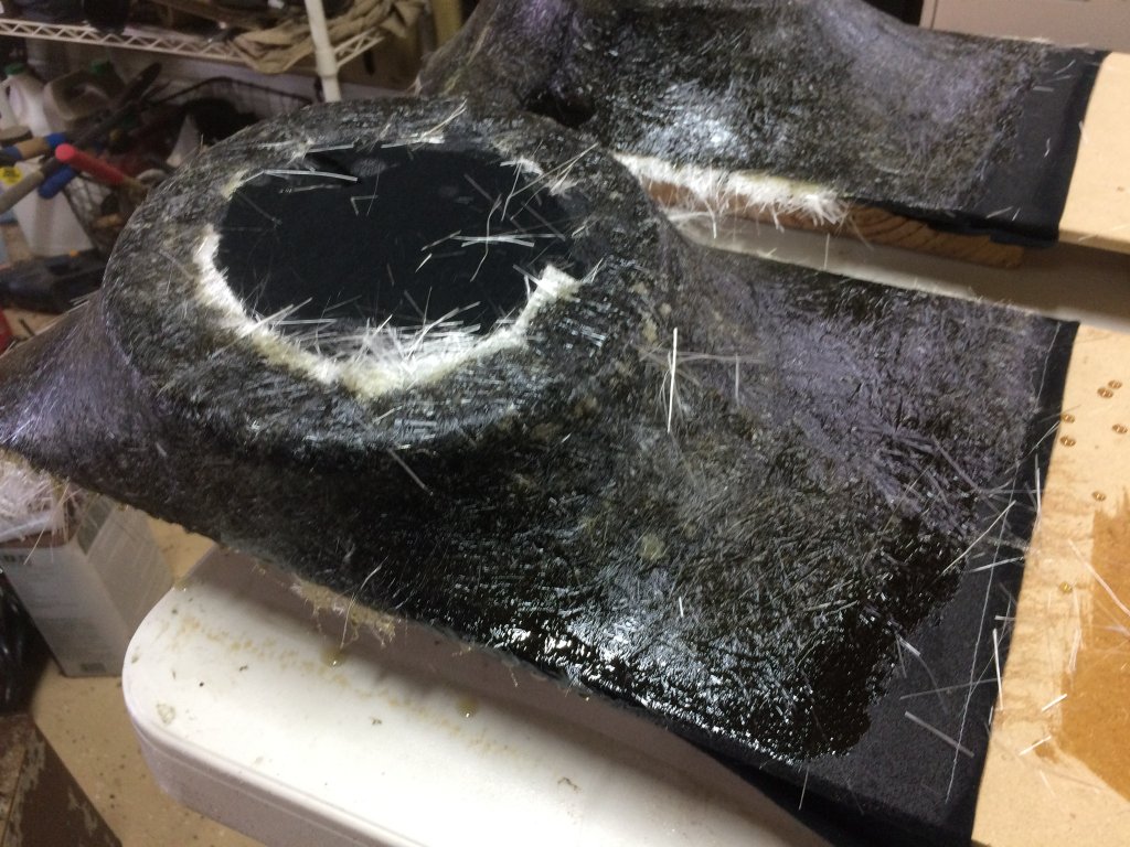

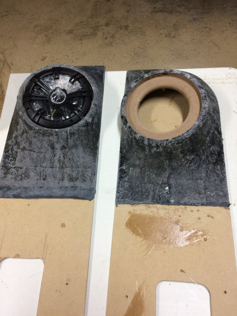

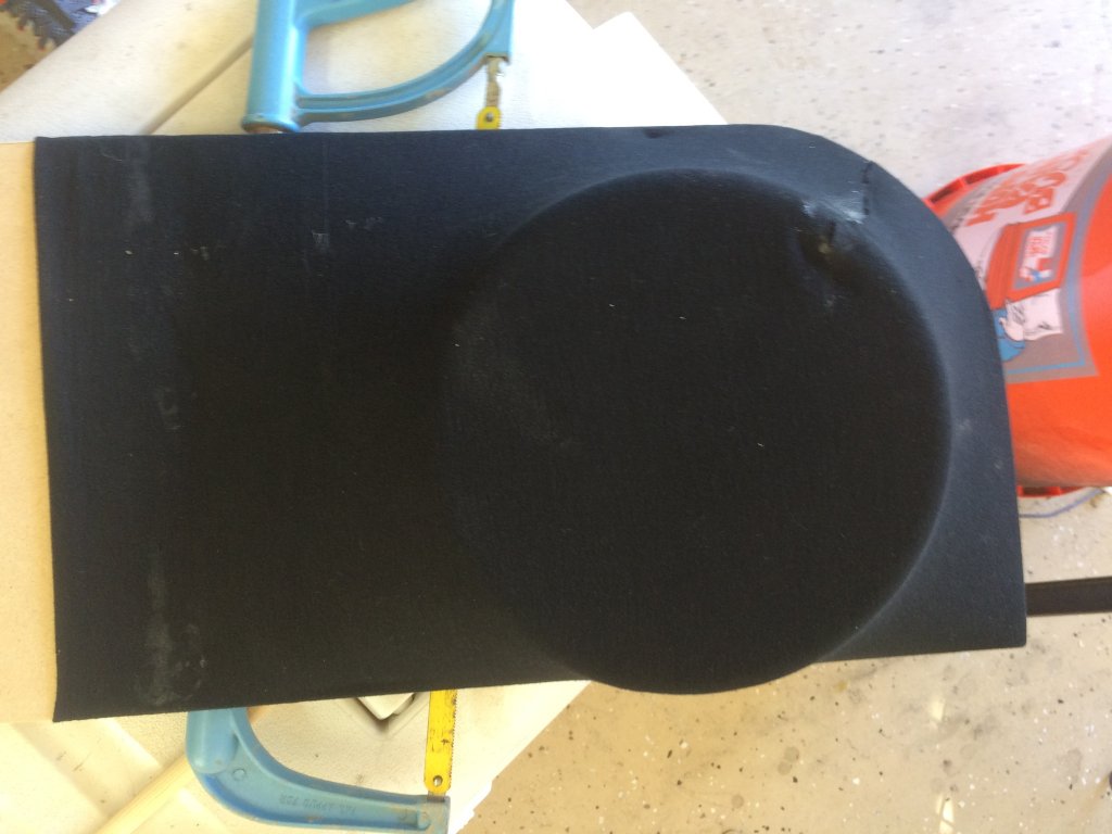

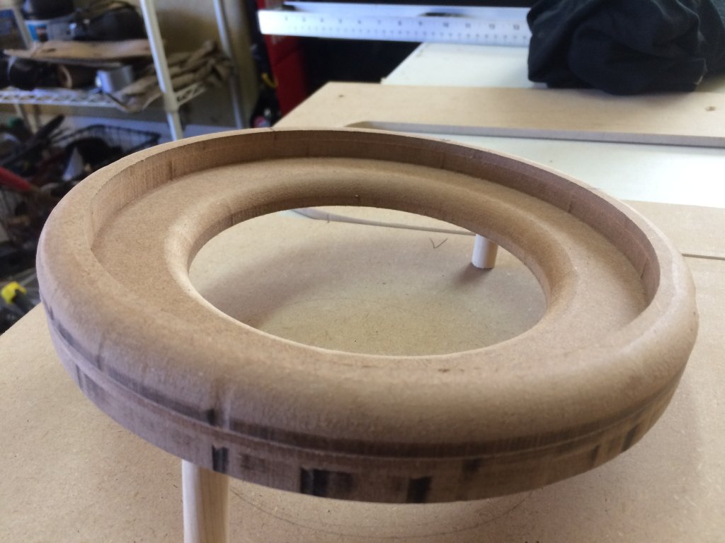

I don’t have a write up, but a picture is worth 1000 words, right? I’m still meaning to Bedliner or wrap them in vinyl.
I did the same without the glass. I made 2, one with a t-shirt and the other with an old neaded up towel. The towel looked better because it looked kinda like rough bed liner, but you don't wanna rub your leg against it lol. I just brushed fiberglass resin on the shirt and towel.

Where do you guys get your fiberglass resin, and can you help me out on how much? I'm going to take a shot at the 4 doors on my 89 crew cab. Never done this before, don't have a good sense of whether the resin I've been looking at is the right stuff, or how much I should have on hand.
Aaron
wlwarnke
Sep 14, 2021
132
186
Helotes, TX
William
Go ahead and get a full gallon. It’s available at Walmart, HD, auto parts, etc. all the same stuff.
I like the chopped mat. It’s easier the get to lay down in curved areas.
Get a box of 2” chip brushes from Harbor Frieght.
I save my yogurt containers for this stuff so brushes and containers are disposable.
Also, latex gloves.
Mix up a cup or so of resin at a time until you figure out how long you have to use it. Hardener, humidity, temp all affect working time.

I just noticed I failed to post a pic of them installed. This was a quick rattle can Bedliner and paint job.
