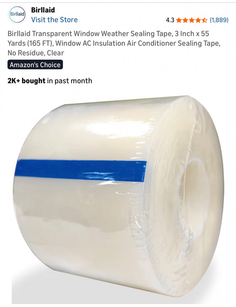

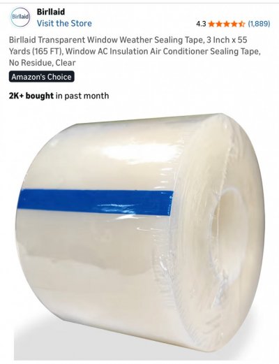

I don’t understand what you’re explaining.
mass on flimsy thin steel panels can help reduce noise transmission. because its adhesive back and thick, its not as good as a dedicated product for this job (commercial products exist for this) , but its about the only thing it would be good for if you already have a plastic barrier in the door.
Think of the noise the door makes when closing , a tinging. instead if you had enough mass on the door it would be a thud, then when driving at speed youre not gonna have as much oil canning. the cab would still do it but its reduced quite a bit considering the doors are the ventilation sources already (worth checking on too, btw) and the door is sealed to the outside around it and the windows have to seal. so already an area where wind noise is expected as a function
Gotcha. Sound deadening material.
I was trying to equate what you were saying to this thread about vapor/wind barrier.
I had no idea they used to make an adhesive piece of plastic like you posted above.
Makes sense, the 86 has air coming thru the drivers door handle.
Odd that it’s only that door and that truck. Neither the 86 or 77 have that big wind blocking piece you posted. But it’s only 1 of 4 doors that does it.

yes, and i was making originally the comment that the OP buying a giant roll of plastic with adhesive backing, his real only inherent benefit to the roll is to apply it to the door skin and evidently the door panel underneath (just gotta pierce a few spots for the door bits to stick through) , the door skin wont help with the wind or vapor but would minor benefits to sound, the door panel one is probably a bit of thermal insulation / wind noise barrier and dust barrier
