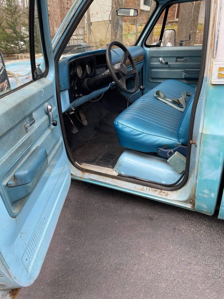

I haven’t taken off my factory door panels yet on my 74. I’m trying to order everything I need to swap em. I pulled the trigger today and ordered some new slate blue door cards with arm rest.
I’m curious how do these attach the the doors and is there anywhere that sells all new hardware for em.
Kinda going in blind as I won’t be at my truck for 2 weeks and trying to order everything ahead of time for it. So I can easily replace everything with out any hiccups of missing hardware!
I tried to search and couldn’t come up with anything specific to the 73/74 doors as I know there are changes over the years
I appreciate any help!

Here just in case these slot into the middle of the door for the lower screws that hold the panel on to thread into there are 4 on each door often they fall out when screws come loose or fall apart from age get stripped out as they are just plastic etc.
Even though I decided to go a different route I saved them to my wish list as it took forever to find them just in case, I need some later.

The arm rests just have 2 screws from the top, they go into a 90° stamped bracket that bolts to the door and has two U nuts for the screws to thread into.
The door panel itself has 4 screws along the bottom, they go into those plastic pieces shown ^ above (73-76 and 77+ are different), one screw in the door handle pocket and two plastic christmas tree clips that push into the door. And remove the window crank. Top of the panel hooks over the door shell and has the inner window wiper felt clipped to the panel.
Door panels/hardware are the same from 1973-1976.
