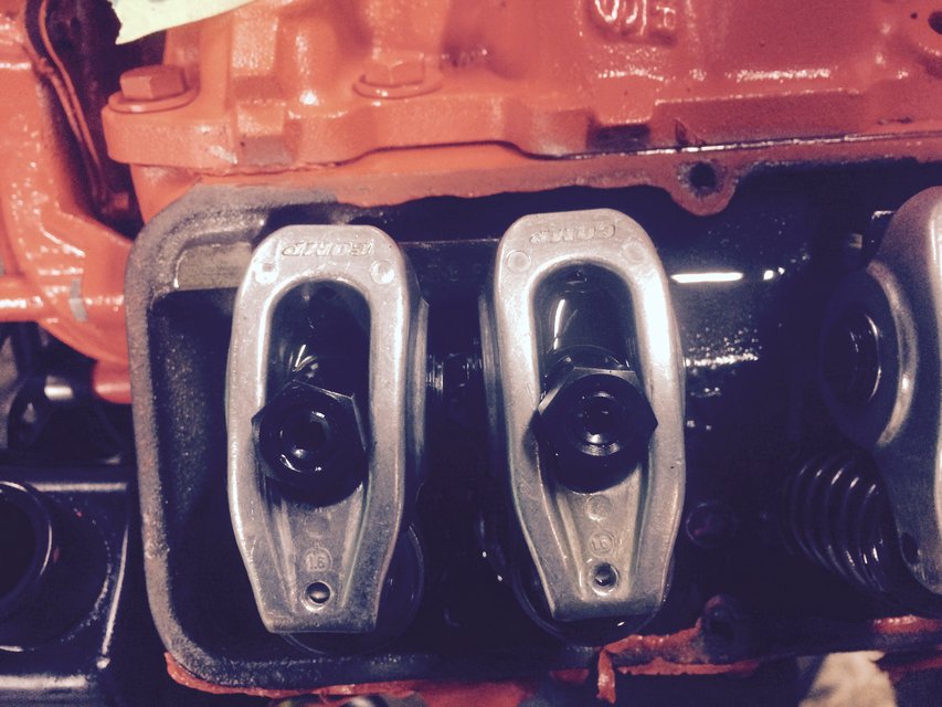

Lol this is quite a spectacle! Going to keep running it and turning engine over !fingers crossed hoping I don't have to pull apart !!

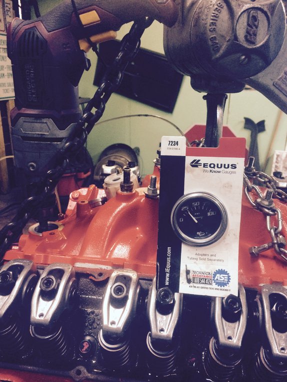

........lol note the zip tied drill!

Getting to the top of engine just primed atleast 30 minutes stuck at 25 # and barely coming out of rocker think just the pushrods are plugged with assembly lube just can't seem to unplug this thing

Still been priming/ rotating engine with no luck anyone have any suggestions on what to do next might pull rockers pushrods tomorrow see if there clogged if not maybe pull lifters? What else could ? Ware does the hole system start? Into the pickup then ware?

Since it's a flat tappet I wouldn't be rotating it anymore, usually one rotation is enough, you can wipe out a flat tappet cam doing that, probably wouldn't hurt to pull the pushrods and check them..
Oil flow..
