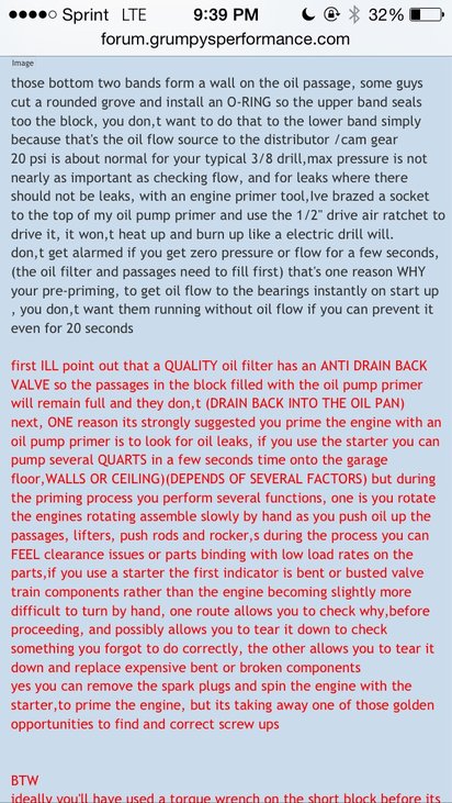

http://forum.grumpysperformance.com/viewtopic.php?f=54&t=985&p=1730#p1730
Here is an excellent read for someone with the same problem and looks like it proved my theory of the primer not sealing at the bottom and 20# being normal (some people adding rubber o ring) makes me feel better but still uneasy ..

Found this
