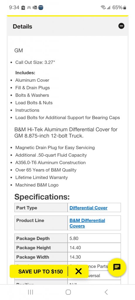

There is no way a 12 bolt chevy,took a gallon and a half on a refill. I wanted to make sure the O.P got accurate information.

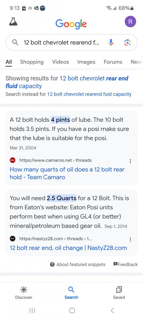

The B&M cover is designed to hold way more fluid than stock. It butt's out further and the fill port is much higher up
6,468
11,005
O.P. I'm going to say just a shade under 3 quarts, please let us know. Thanks

Not wanting to stir the pot, but just clear things up.
Pretty straightforward to check into…
Says the b&m cover adds 1/2 quart capacity.
Jegs kit with the b&m cover comes with two quarts of gear oil, it looks like.
What are the chances you put in 3 bottles of gear lube. Now if you were thinking the bottles were 1/2 gallon I could understand you thinking you put in a gallon and a half. The bottles are quarts. Also what are the chances you filled it until oil ran out the hole in the rearend cover? You are only supposed to fill it until it runs out the axle housing fill port,then stop filling and replace both fill plugs. If you didn't do that it will allow you to grossly overfill it.
