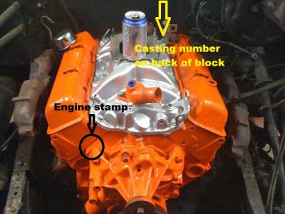

Perhaps this will help.
We do know it's an 010 block. But that doesn't mean a lot.

SUCCESS!
there were 2 numbers on the spot indicated on the previous picture by Retro
V0201TYY
C7Z156801
Hope this is it!

TYY 1975 350 conv.cab L LS9 165 4 C-10 to 2500

You have a 165hp 350 from a 1977 C10.
Well I'll be. So basically should I be searching for that model when ordering parts for engine stuff?
Thanks to everyone for all your help. That was really fun, I think I am going to enjoy fixing this truck up.

I would. And that's what we're here for. :cheers:

Being a first a early sbc you can pretty much order anything for it from so many various years not just a single year.
