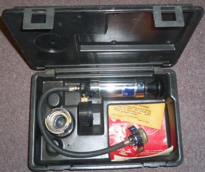

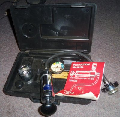

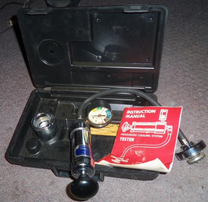

So, since it's been brought up lately. Few more toy pics and recommendations.
This is my Cooling system pressure tester. Awesome tool to have for looking for leaks and even detecting blow head gaskets. If pressure is rising rapidly, then it's a good assumption that compression may be leaking into your cooling system. This one is outdated being most systems don't have a radiator cap anymore and are sealed, but it does still work for Squarebodies that have REAL radiators. The other part is an adapter. I recently used this to test that used heater core before I installed it. Hooked it up the heater hoses outside the heater box, and pressure tested. Didn't lose pressure, Core never got wet, so I knew it was a good one.

I got one of them too. :)

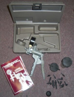

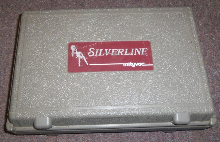

Next, One of those things most of us would rarely use. I used it alot for testing Vac Modulators on Transmissions and Testing EGR valves for Emissions testing when I was a Cali Test and Repair Tech. I recently used this to test my Vac Diaphrams on the K1500 Air Distributor to try and figure out why the Blend door to the defrost isn't working. It's not the diaghram. That's good.
This is a better kit. It can also be used to bleed brakes by yourself with the Cup and the flow thru lid adapter. You can get this in plastic too, but the aluminum one is better of course, and you do pay for it. This is also a rebuildable unit. You can take it apart and replace the rubber seals and spring inside it. This thing is probably 25 years old now and so is the Stant Cooling System Tester. I bought these items brand new the same day.

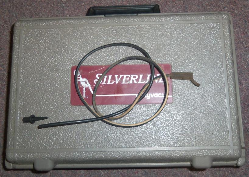

When you have one of these, you'll acquire things to add to your kit as you use it. For example, I cut this piece of Vac tubing from a truck at PAP so I could use this line for testing the HVAC Vac diaphrams. All I do now is use the Mighty Vac adapter, and put it on the OEM hose, and use the OEM connector and can test my HVAC diaphrams, no problem.
