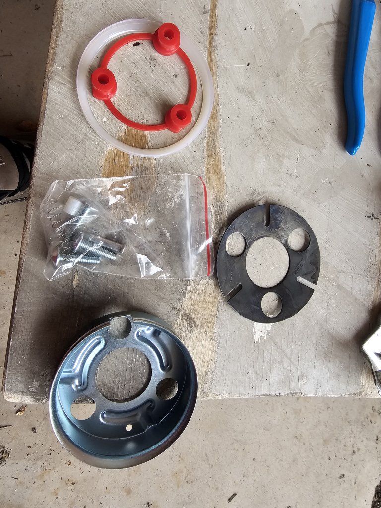

What are the size and thread of the 3 screws that hold down the horn contact button. Mine have disappeared apparently.
Or a kit that ships to Canada I need the cam contact plunger spring ect anyway.
I just wanted to put the horn cap on temporarly in the mean time

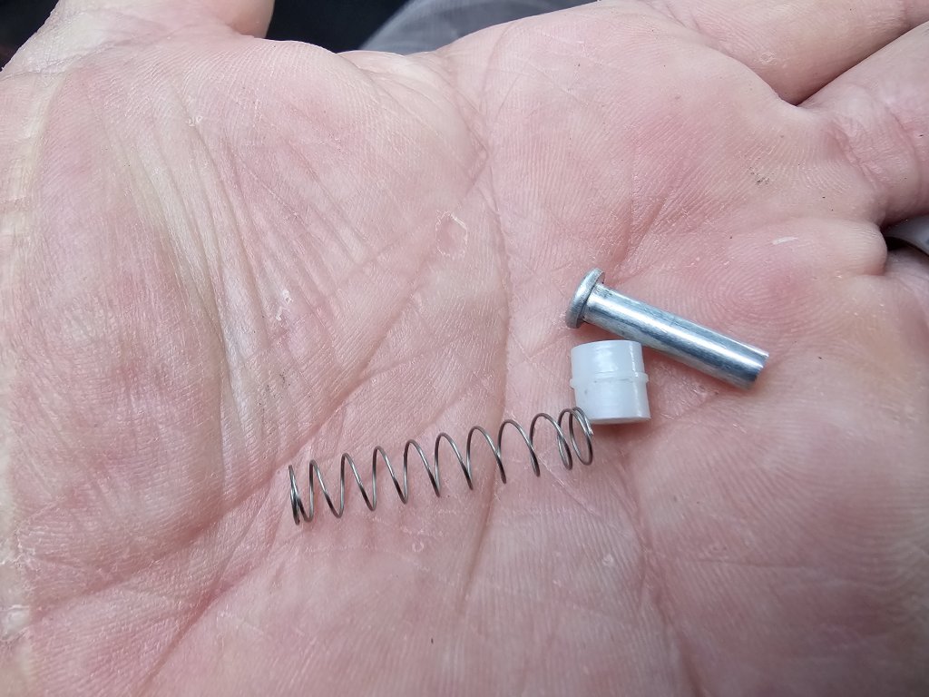

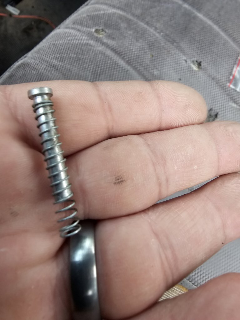

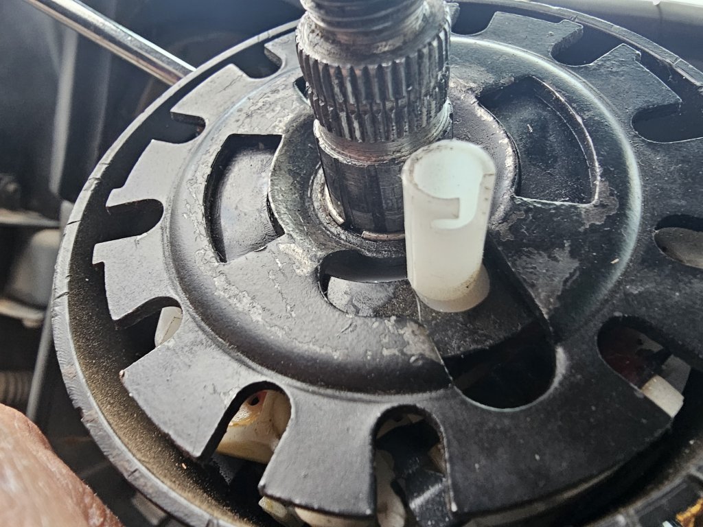

Speaking of, can anyone tell me how these are supposed to go in? The picture with the little white plastic ferrule came in the pack I recently bought
The previous kit had a green plastic peice with a tab that locked in, but I broke the green locking peice when I was messing with my steering wheel. The picture with just the rod and spring is what came with that original kit

I'm pretty sure you put the spring in first, the the plunger flat end down the hen that plastic piece locks in there
