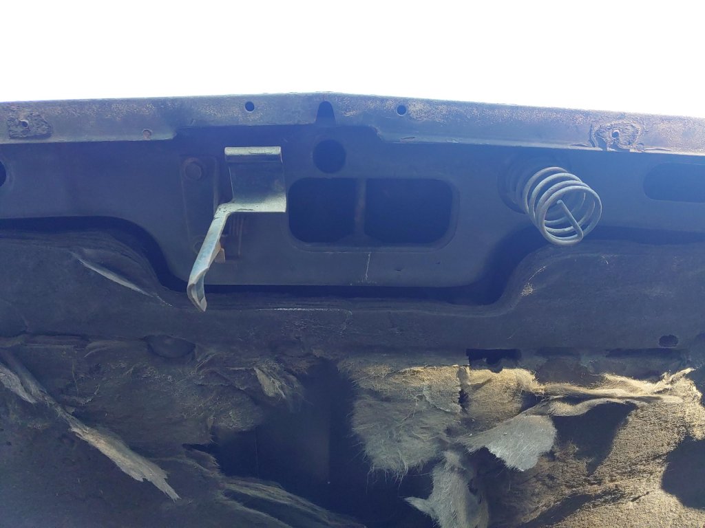

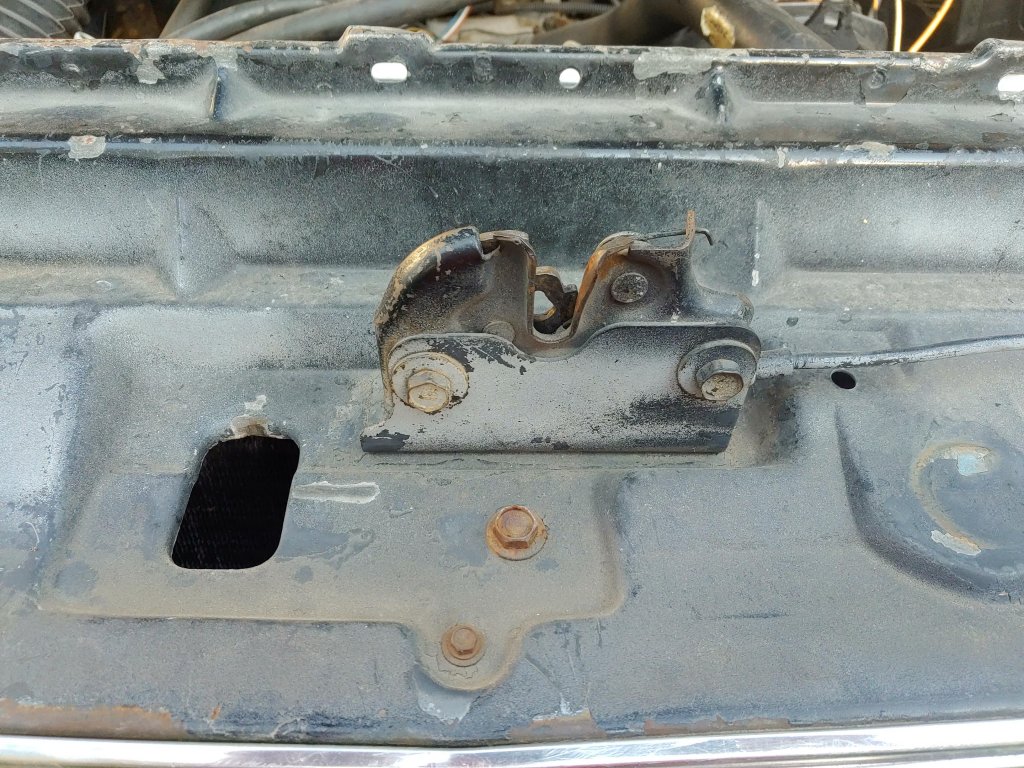

Check out these photos guys. I was never able to get it to latch. What do you think?

I think the latch looks closed. Bet it don't shut worth a damn like that! :nono:
Move the hookey over to the other side with your finger and try again. The "return spring" looks like it is broke or otherwise missing.
Thus, it is unable to reset- you'll have to do it manually.

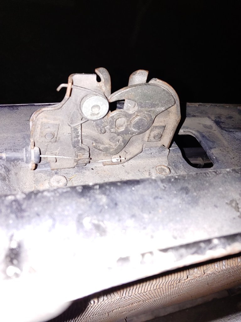

I tried that and it didn't work. Here is a photo of the back side of the latch. It looks like the catch on the under side of the hood isn't even getting down far enough.

The latch has been hammered on the drivers side. The latch needed to be adjusted towards the driver's side. The striker bar in the hood is hitting the wrong side of the latch trigger.
May be too late now since the latch is so bent down. If you move it now it will probably lock, but being bent it might not release. I would look to replace the latch with a good used part.
The two bolts facing the front are in slots. Loosen those two bolts and move the latch towards the driver's side if you want to try adjusting. Please add some oil to the pivots of the two moving pieces.
