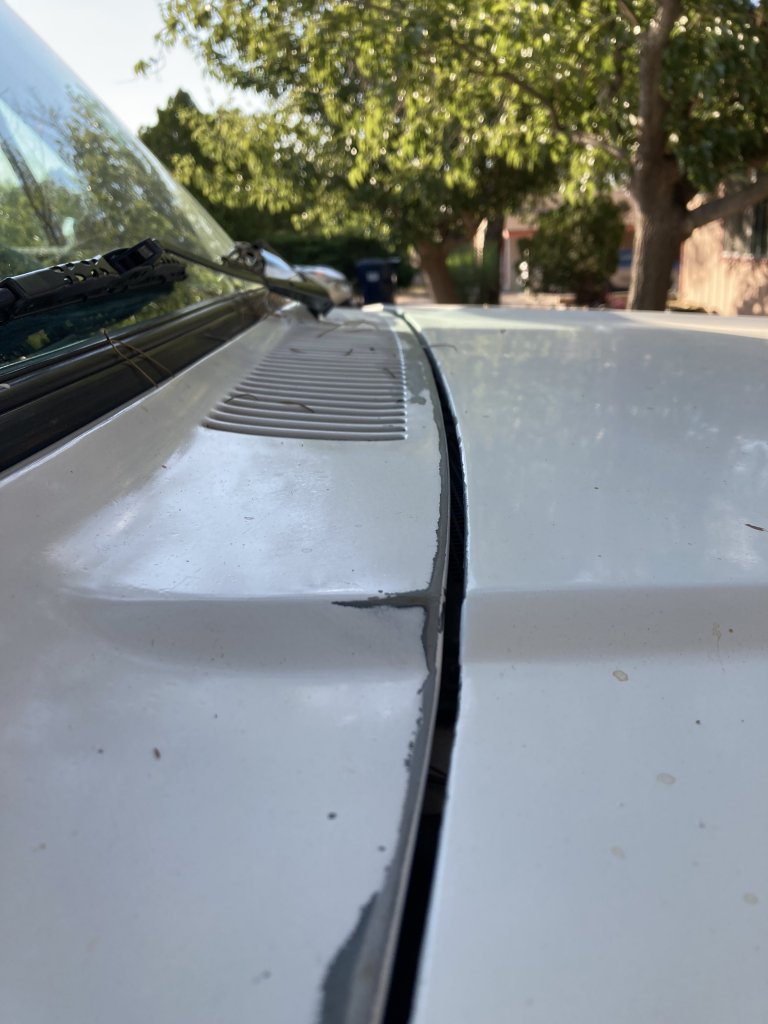

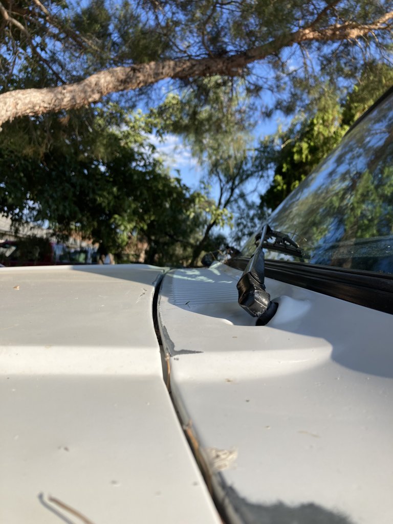

I replaced the hood on my 84, with an original hood but I still can't get the back to sit down flush. Someone mentioned shimming the cowl panel. Anyone ever done that? I also have to slam the hood to get it to latch. I think I may have to spend some time messing with it
