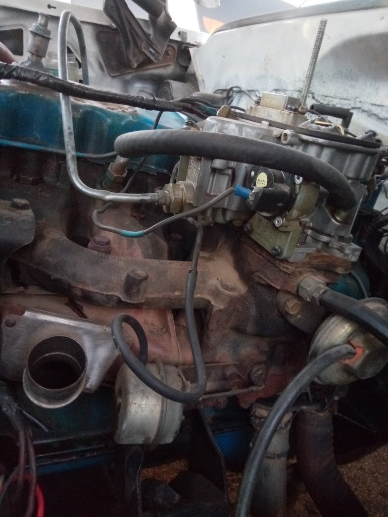

It's an inline 6 4.1 with the 2barrel Rochester varajet carb and I wanted to put the original 1barrel back on because I'm not sure what goes where in regards to the EGR plumbing and vacuum lines go. The guy who installed the engine left it undone and a mess. Also I'm not sure where the adjustment is for fuel and air on this 2 barrel varajet carb

There is a good chance the 2 barrel has sealed mixture screws, that is why you don't see them. A mini plug covers the screw. You can remove the plug with a small hole saw tool, also hard to do correctly. Then the screw inside is not a slotted screw, you need another special driver/socket. Looks like a double "D".

I know the tool that you speak of I was actually trying on a area on the carburetor not prime but digging into where I thought the adjustment mixer screw was and it just seemed like if I was doing too much work so I just sealed it back up before I went too deep now I was probably in the right spot but then again I didn't want to damage something to the point where I had to get a new carburetor or whatnot so I'm going to send some pictures out right now

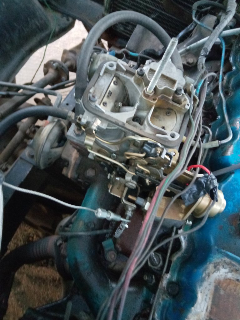

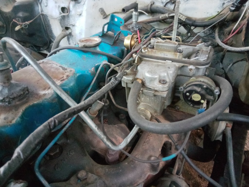

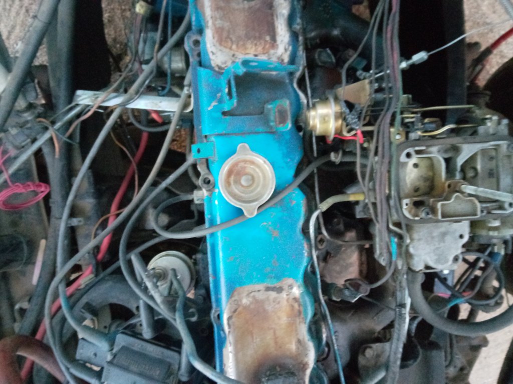

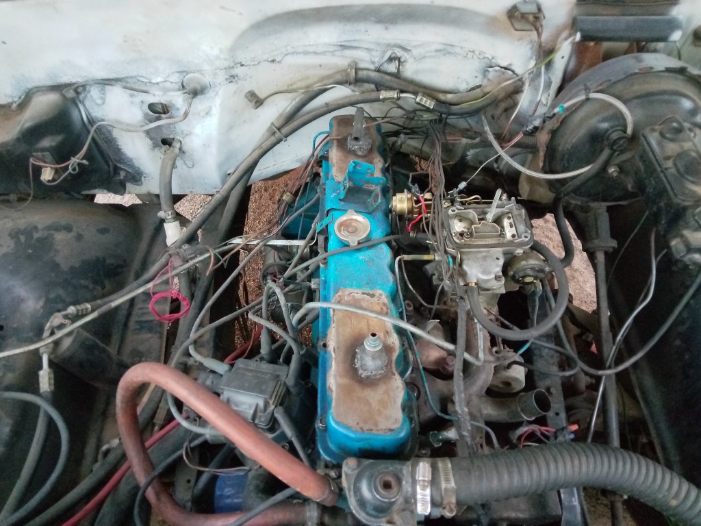

Here are the picture sorry so late but I only work on it when I can

Now according to the owner the previous mechanic cut off some theme from the valve covers that it looks to me hold PCV valves or check valves and run back into the intake or run back into the valve cover I'm not really sure but the lady said that he said that they didn't need them anymore and I don't know exactly where to start after that so if I need another valve cover or am I able to work with what is if you need some more pictures I just barely got here so I'm going to start getting my hands dirty in a little bit

I just recent valve job on my '81 C10 with the same engine and set up.
this is my vacuum diagram:
This picture of yours shows a large vent line going from the fuel bowl, around to the canister vent purge inlet on the carb base:
Remove immediately, that is not the proper routing. This allows a lot of extra air to be sucked out of the fuel bowl vent directly into the intake manifold. This is probably killing the engine at idle. Route the two large hoses to the vapor canister by the radiator.
