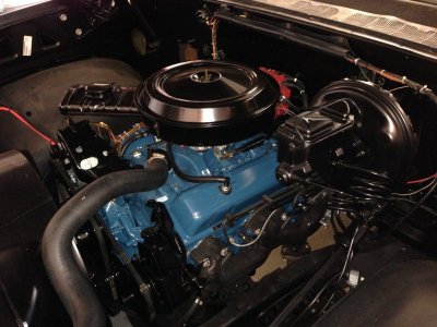

Don't know how much taller than a points type but I can tell you that a HEI will fit in it's place. This is my 74 that was original points style converted to HEI. It's tight but will work.

Robert, that is one clean looking engine compartment. woodsrider if you want to keep the stock air cleaner and the hei interferes why not just get the factory lower housing for hei and put your lid on it highdesertranger

It's even tight for OEM HEI trucks. It should work without issues.

Thanks for the replies. That is indeed one spotless engine bay. My 74 air cleaner doesn't look like that. Mine has the heater tube off the exh manifold, and hot air choke. The body is probably 2-3" more in diameter than that. I guess when you think about it top of q-jet is same no matter what. Stock points dizzy it tight, so wanted to make sure. New HEI vs Pertronics is same $$, but I'd rather go HEI for obvious reasons. THANKS!

That is a stock air cleaner off a 77. The engine the cleaner came off of had a heater tube off the exhaust manifold and hot air choke.

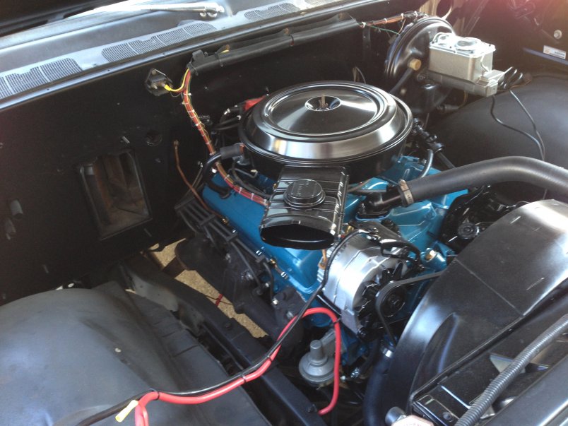

If you are talking about the plastic tube that the wire is in I would say yes. I am in the process of re-wiring the truck and I am going to hide as much wiring as I can so that will go away. It will be a few weeks before I remove it but if you want it you can have it for shipping.
