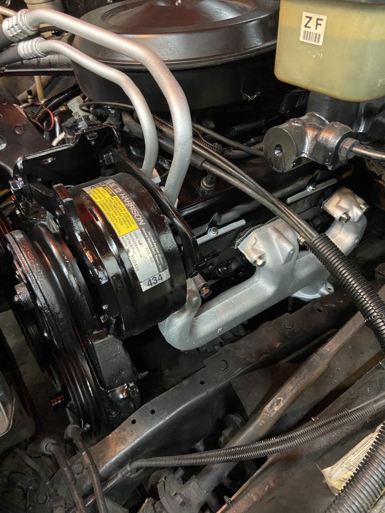

I used manifolds off a 87 the flow just as good as headers in a stock situation.

Run what you have access to manifolds flow well, the ram horn style flow a little better. I picked up a fancy set of 50 state legal shorties from Edelbrock. But I only picked them up because I have a Edelbrock top end and fuel pump and wanted everything to match. In retrospect, long tubes flow more everywhere=HP/TQ/MPG; but may not provide as much ground clearance. If you do come to the dark side, make sure you use a high quality set of locking header bolts, and make sure you are confident swinging a ballpein hammer to get the spark plug clearance you want. Be sure to true them up pre install. And don't drop oil on any ceramic coating - ask me how I know. If you stay with manifolds, I have had good luck with powder coating or even 2 stage PPG turns out sharp.

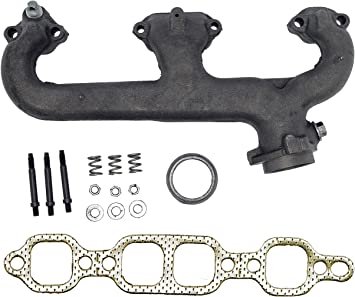

Manifolds in '87 didn't have the ports for the air injection off the smog pump??? What years had the air injection system?

Dorman Part # 674-231 and 674-158
