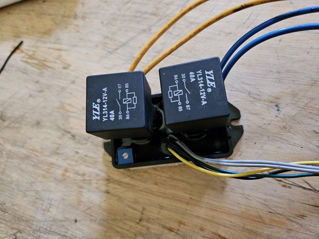

In one of my other threads about the rad fans not coming on when they should. Basically, an over heating problem due to some issue with the fan controller. Well the problem has been resolved. I had cslled Summit about the issue with the controller and they "warrenty'd" the first unit out. Thank you, Summit. Second unit was not any better. So late yesterday afternoon, I had enuf. I went to summit and got a controller with a better design and a "better" price tag. Touted as "Painless". By 10:00pm I had the faulty unit out and the "Painless" unit in....mostly. Batteries in headlamp gave up....and so did I. This morning found it in the same state I left it....night shift never showed up. Buggers!
So, wired in the last couple wires and loomed the harness up to tidy up the bay. Gads, I hate to see a wiring hairball in vehicles.
Ate lunch and went to Summit to return the p.s. bracket I never opened and the p.o.s. twin fan controller. Then came home and got the Mrs. and we spent the next hour or so yard sale'n. And the new painless controller kept everything under control, including my temper.
So, as I was futzing with the first controller, it had a bedded temp control trimpot. There were times I could just press my finger on it and the fans, which should of been screaming, would come to life. Then there were other times, regardless of how I adjusted that pot with a screwdriver, it would not come on, and both fans should be on.
Honestly, I think there are issues with that $40 controller. But it's gone now.
