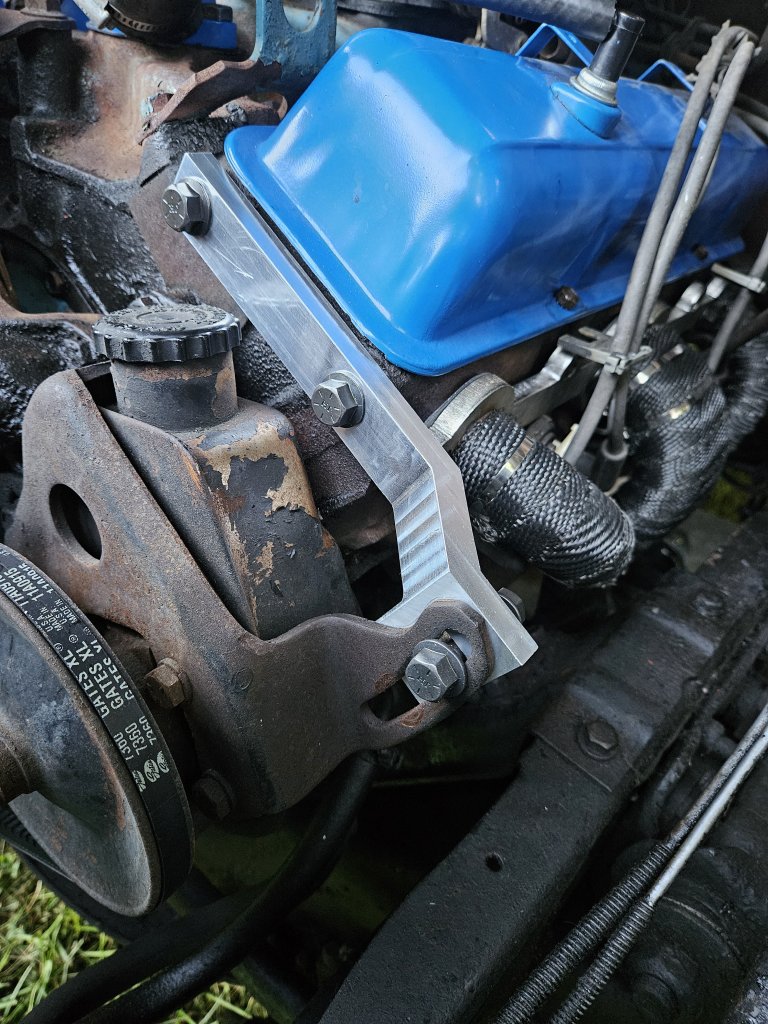

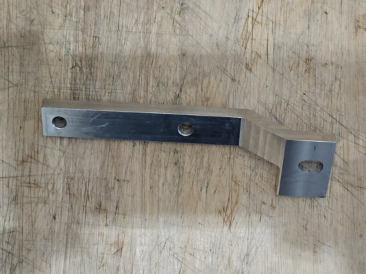

Since outdoor work required playing russian roulette with the extension cord, I decided to fab a P.S. bracket.

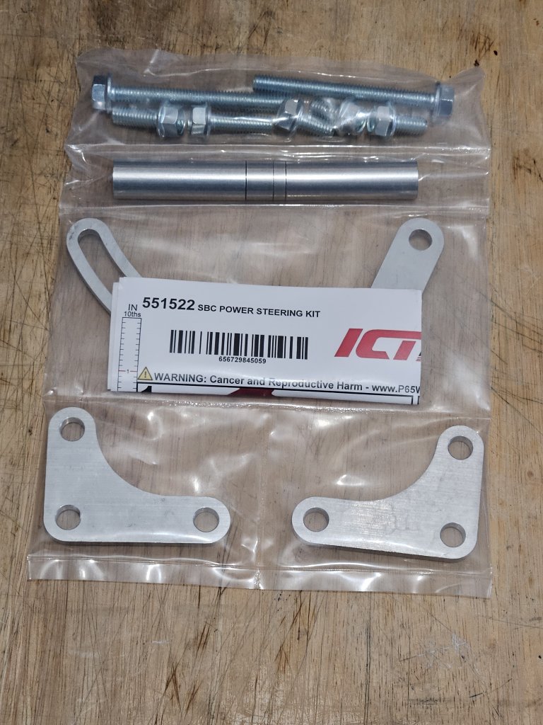

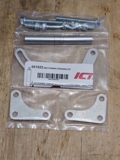

Yes, I did buy one from Summit, but I really didn't like the flavor. Besides, that you then had to measure for a new belt because that bracket changed the position of the pump.

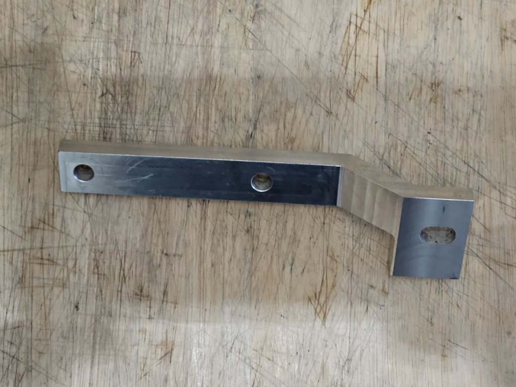

So once again I broke out the handy CAD system and had a cardboard prototype in hand in minutes. Took some measurements cause them be handy for lining up bolts. Took about 5 hours to carve this one out and the nice thing is, the stock belt stays. I have some belt sander touching up to do and I'll probably paint it. (Where did I put that can of Greasy flat black paint? )

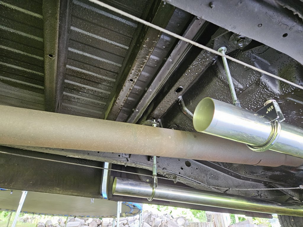

Well...I may have screwed up.
In the picture you can see the exhaust hanger is "hard" to frame. No "rubber baby buggy bumper" thingys. And man you can feel the engine vibration thru everything.
I will have to cut up that semi mudflap and fab some.
Here I thought I did such a nice clean job, but once I started it up, it started to unbolt itself, starting at the back. Then I realized where I goofed.

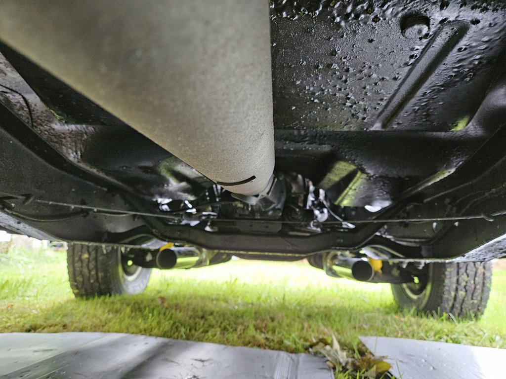

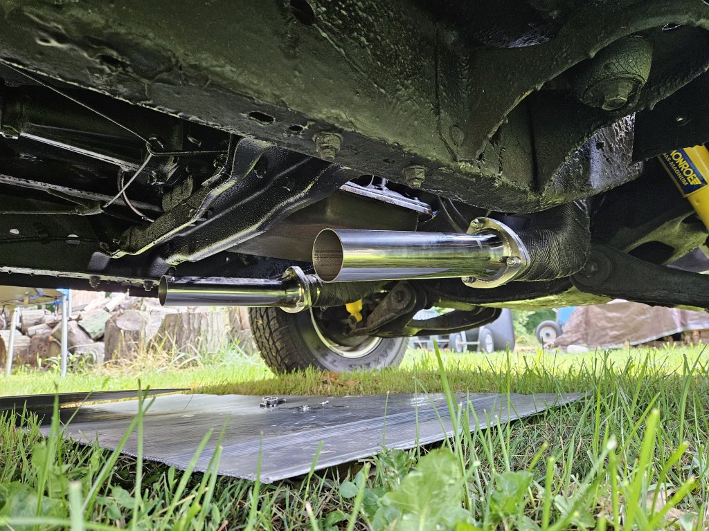

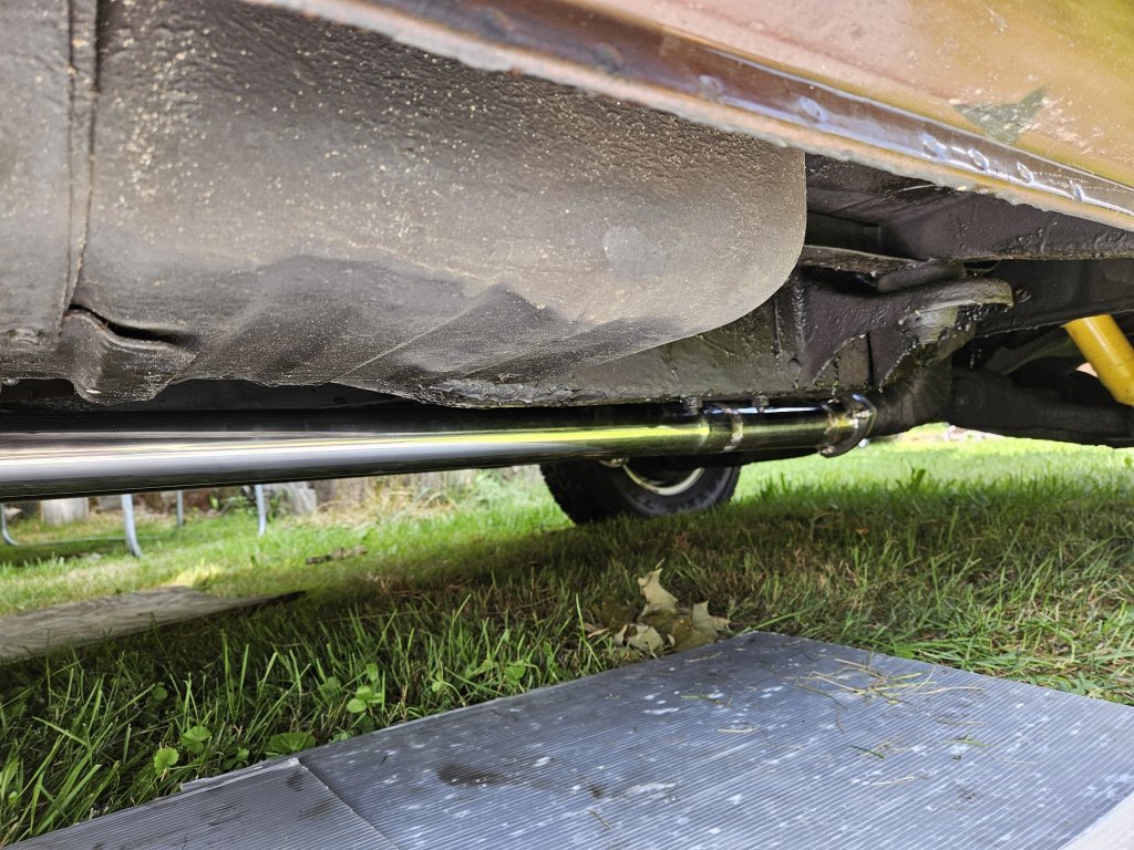

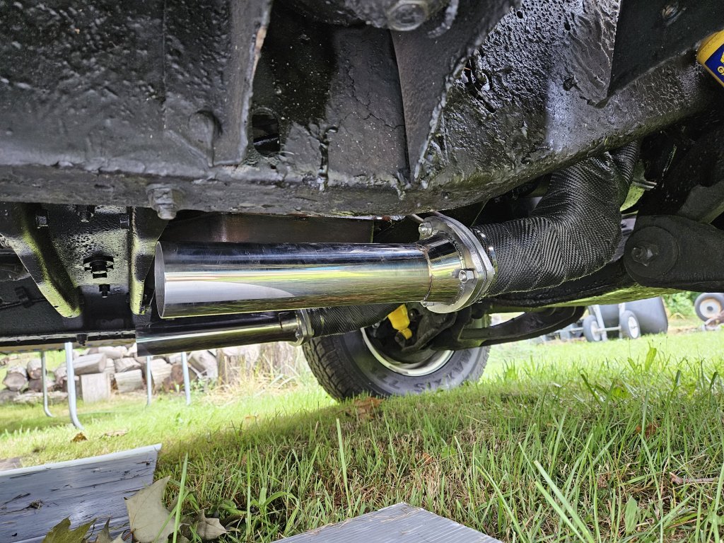

Inspite of my error, the exhaust is on.
Where the header terminates the pipe points toward the ground and turned in a bit toward center. I guess they are all like that, but that just looks silly. So I took a protractor and determined that it's about 7° pointed down and about 7° pointing inward. Instead of trying to notch out the reducer on 2 axis, I used a CAD program to draw what I wanted and then find the vector of those 2 angles. I cut and "birdmouthed" the reducer right at the beginning of the straight section. Tack welded it then bolted it up and check alignment. After that, things went pretty well. Just time consuming.
Brother, am I sore from crawling under & out from under that truck.

Got the isolators fab'd up and installed in a couple hours. What a difference! Lol.went for a tool around the block. It sounded amazing.

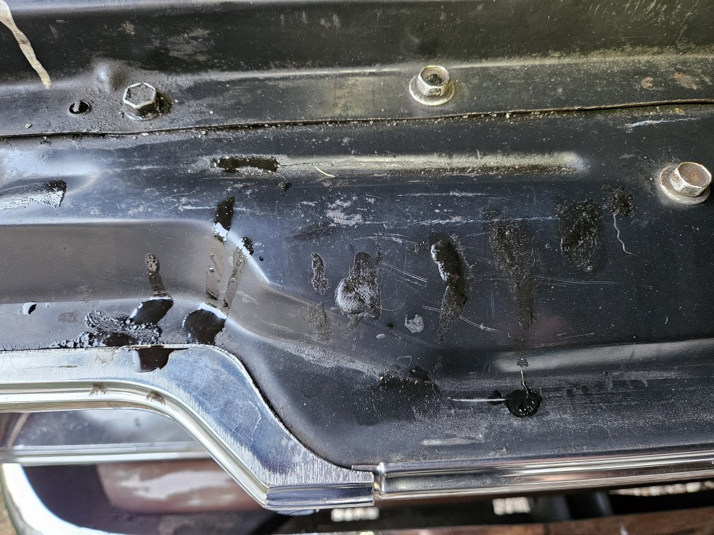

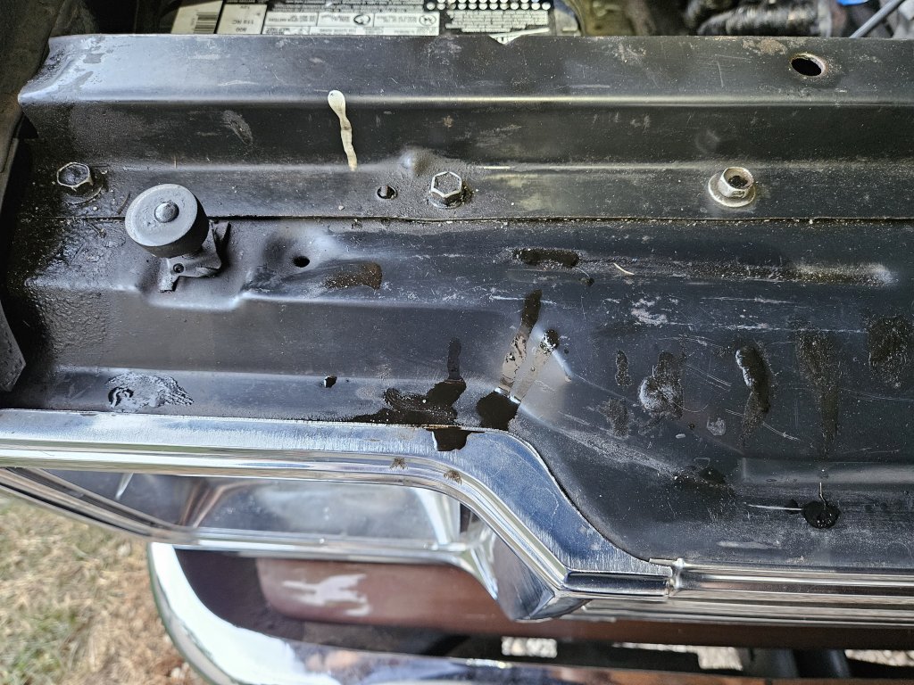

Oh fudge...
These pics were of the 46 year old under coating still dripping (on a daily basis) out of the hood.
Sorry, I'll get pics of the isolaters up in a few...

The P.S. bracket low-down.
First off, thank you for the compliments.
The ps bracket started out as 2-1/2" x 2-1/2" x 12" square aluminum bar. I carved it down from there. That took about 4 hours of manual machine work. (Not rushing). I have years of manual and CNC machine experience and I'm way older than the truck. I figure my time, on a manual machine is worth $50/hr. not counting material cost.
The bracket kit from summit was $45. And that was cut on a CNC, tumbled , and shipped. It probably took a total of 5 minutes cycle time from start to completed part, if that long.
I don't know of 1 single person that would pay a guy $200.+ for that bracket, when $45. options are out there.
It's all about "what's the least expensive"...
I had the material in my stash and it was raining cats-n-dogs, so I had nothing better to do than cuss the weather.
A guy can't break even making parts in his garage.
But I do appreciate the kudos. Thanks.
