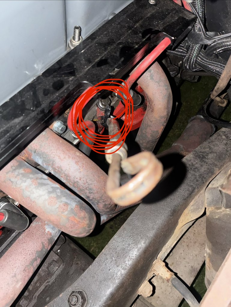

Hello everybody, hope you guys are all having a good day, I have a quick question, I recently was replacing my header gaskets and I bent the dipstick tube out of the way to get the header off and it broke away from its tab that’s held on by a head bolt. My question is can I remove said head bolt to repair the tube without compromising my head gasket seal. As long as I put sealant back on the head bolt since it does go into a water jacket. I have attached a photo for reference. Any help is greatly appreciated!!

I've done it in the past with no issues. Drain the coolant in the radiator before you pull the bolt, or you will have a lot of coolant on the floor.
