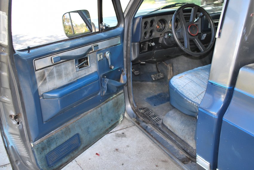

If you go that route I have everything for the manual setup except the door panels. If your not picky about the door panels your existing PW/PL panels will work. This is my 86 when I first got it. It had manual windows with PW door panels.
