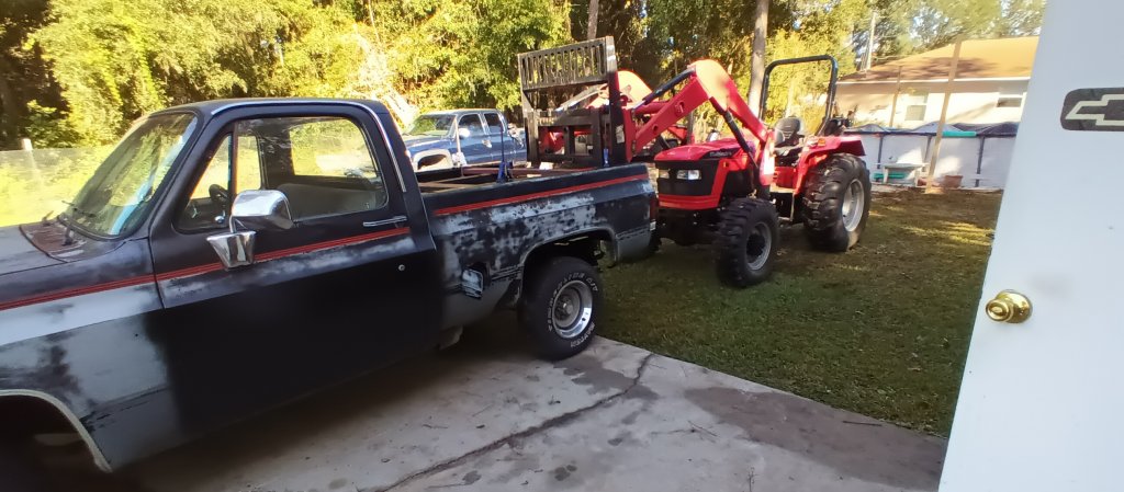

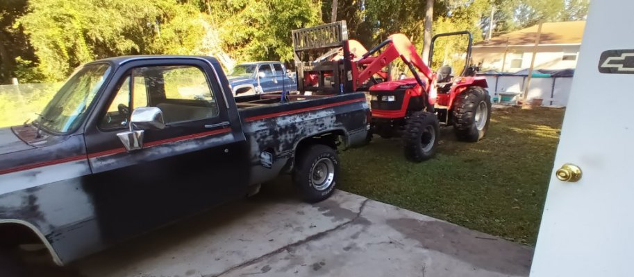

I've used a few bed lifts when I worked in shops. They work great, but you have to make sure you engine hoist will raise it high enough to clear everything. But kinda pricey for the amount of time your going to use it.
I used a couple of scrap 2x6 boards and a chain, but my engine hoist decided to blow a cylinder seal and crap out on me.
I ended up using my tractor with forks to do the job....I still haven't fix my hoist.
