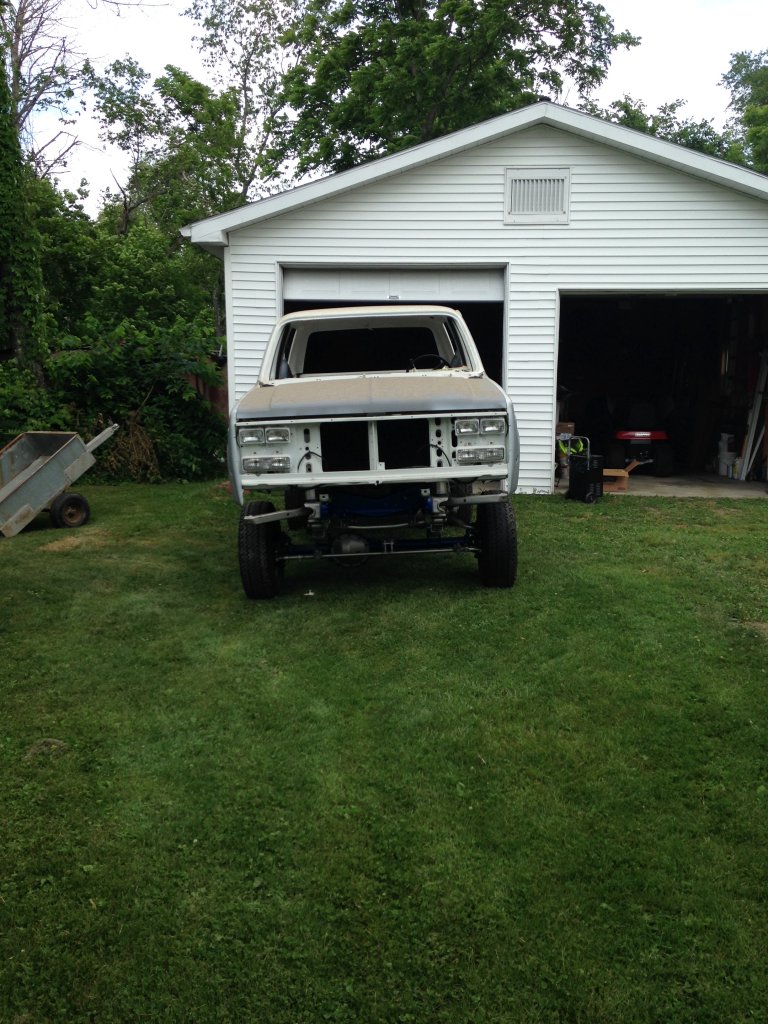

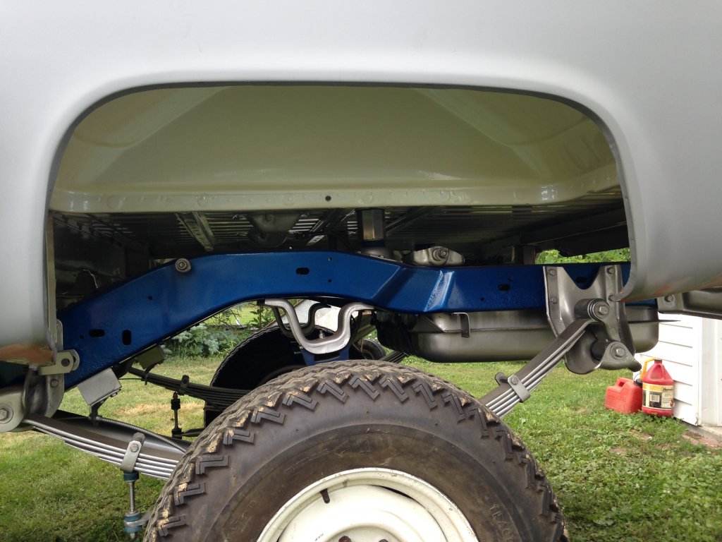

i cant seem to find any decent pictures of a 3 inch body lift. ive been thinking about putting one on but im not sure how much the frame would show let alone the fuel tank.
3 inch body lift 6 inch suspension

Would have to dig around to find my old 80 K5 that had a 3" body and 4" suspension lift. They do look a little funky with the front bumper valance panel being above the bumper, big gap above the rear bumper and tailgate (roll pan fills in the space nicely though lol), fuel filler neck needs a bit of help, radiator shroud needs to be modified, shifter linkages need to be adjusted and steering column needs some tweaking as well. IMHO, don't do it because it looks like ass. Personally I'd say to just go with a 6" or higher suspension lift, or 3/4 ton springs and be done with it.
